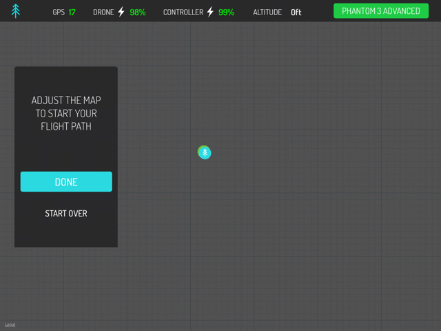

Just did my first flight. (Mental note: bring gloves when it's cold) On the Ipad no map visible. I pre loaded my flying area in close detail, but nothing visible. With my Iphone on 4G no problem. The only thing I could not change was the imperial to metric settings. Go is in metric on my ios devices, and Airnest in imperial. Also on the Ipad there was no screen from the camera. Just a black screen.
As you can see no map on the screen.
Just did my first flight. (Mental note: bring gloves when it's cold) On the Ipad no map visible. I pre loaded my flying area in close detail, but nothing visible. With my Iphone on 4G no problem. The only thing I could not change was the imperial to metric settings. Go is in metric on my ios devices, and Airnest in imperial. Also on the Ipad there was no screen from the camera. Just a black screen.View attachment 36373
When using Apple maps as our app does you do need to preload with an Internet connection but it can only cache so much, we cannot control this amount. You should test it prior to going out by going into airport mode and loading it up.
The camera feed issue does happen to a few people and we have a fix coming very soon. You can also change to metric by simply touching the altitude text at the top of the screen while connected. All values will then switch to metric.
