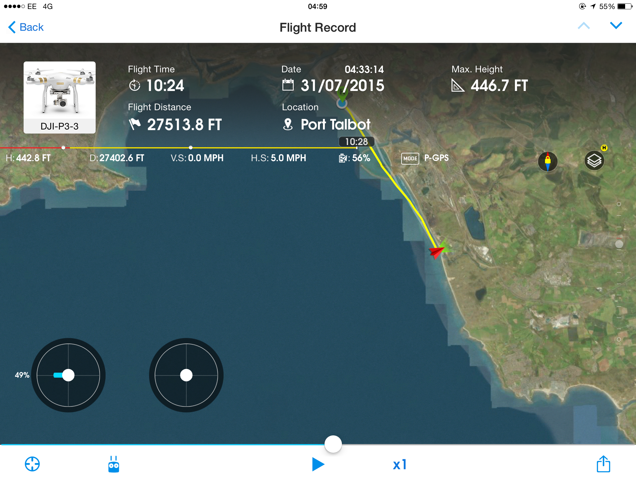

27400 feet... DBS Itelite antenna rocks. Anybody who wants to say this antenna cannot deliver?
x8 speeded up Video - whole flight compressed to less than 3 mins
WOW. You made it all the way back? Home much battery at landing? Battery mod?
Yes all the way back - 11% left. Battery mod as described earlier in the post. There is x2 extra 1000ma batteries
