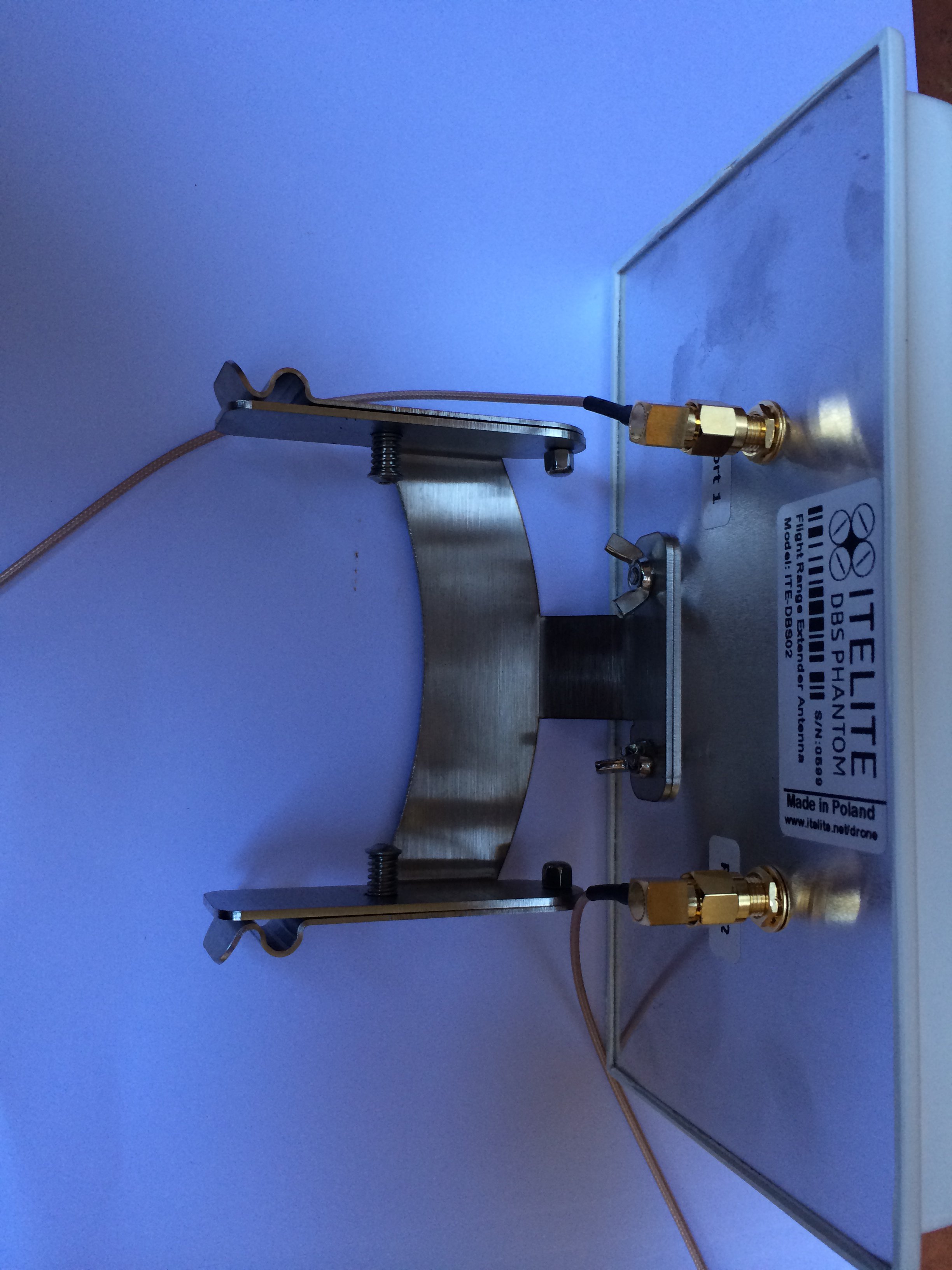

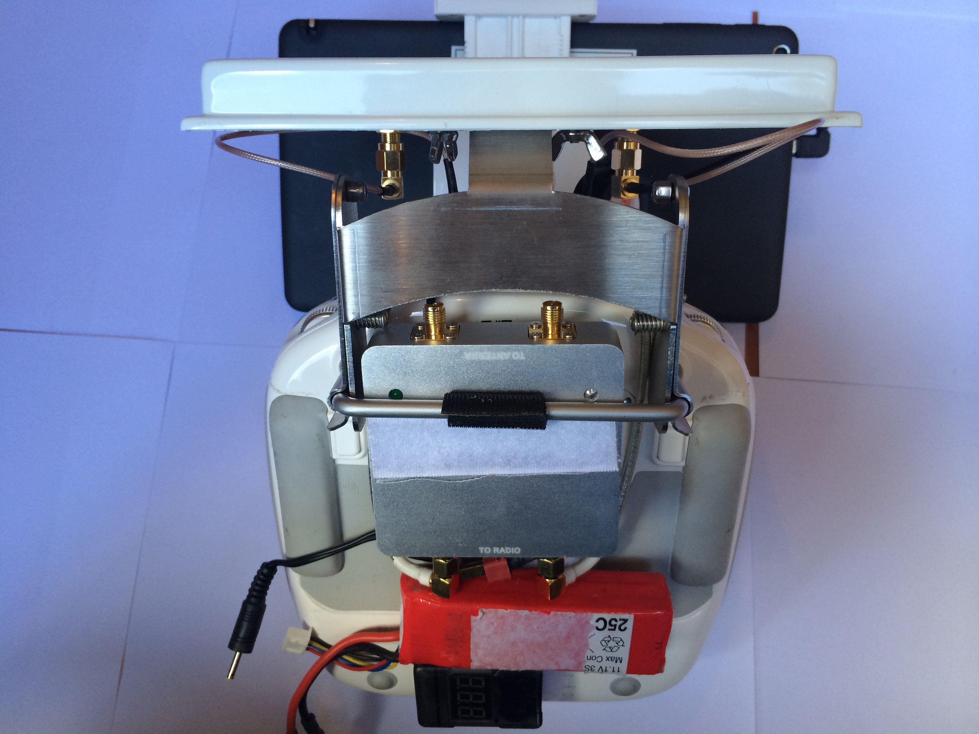

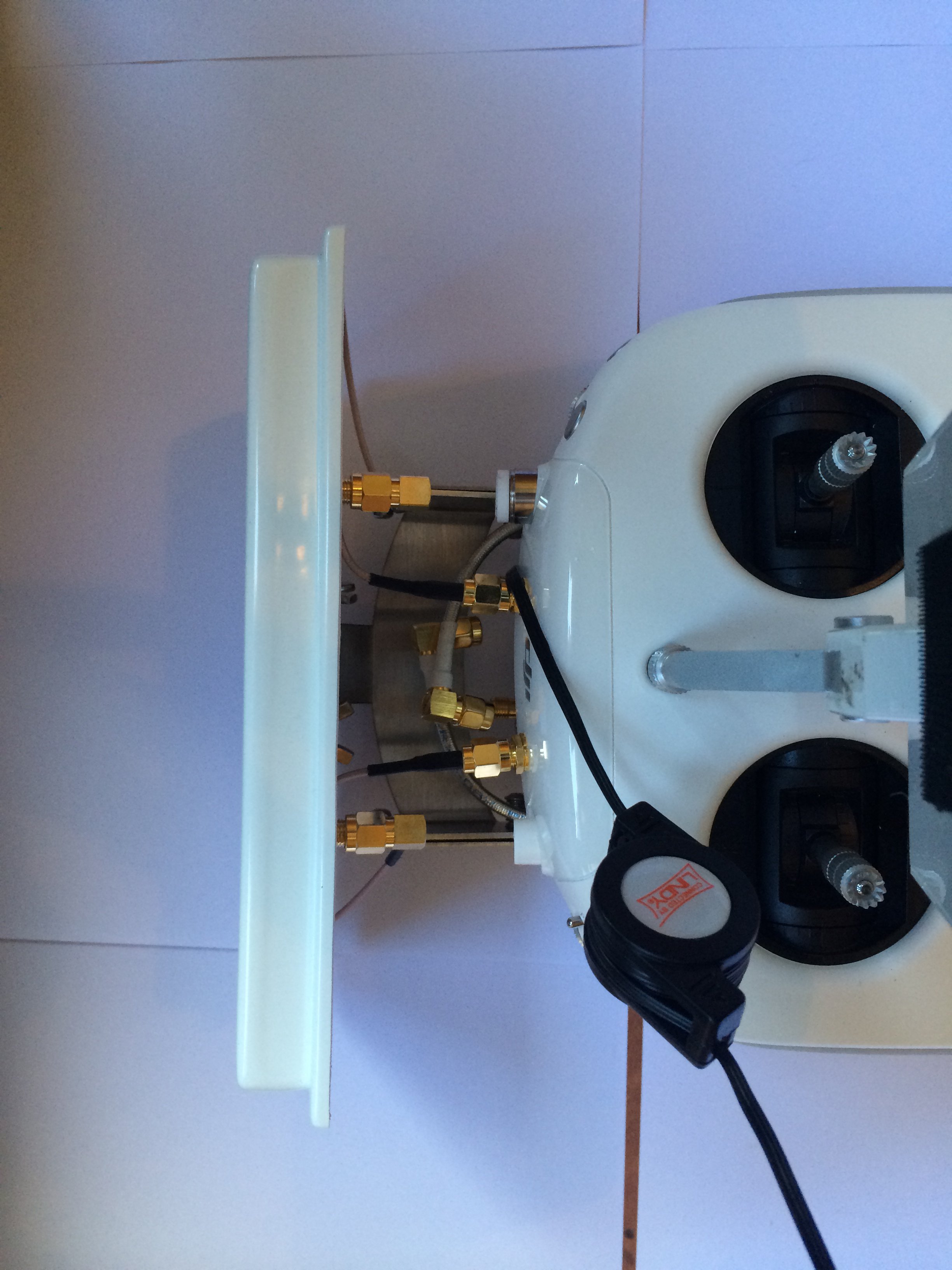

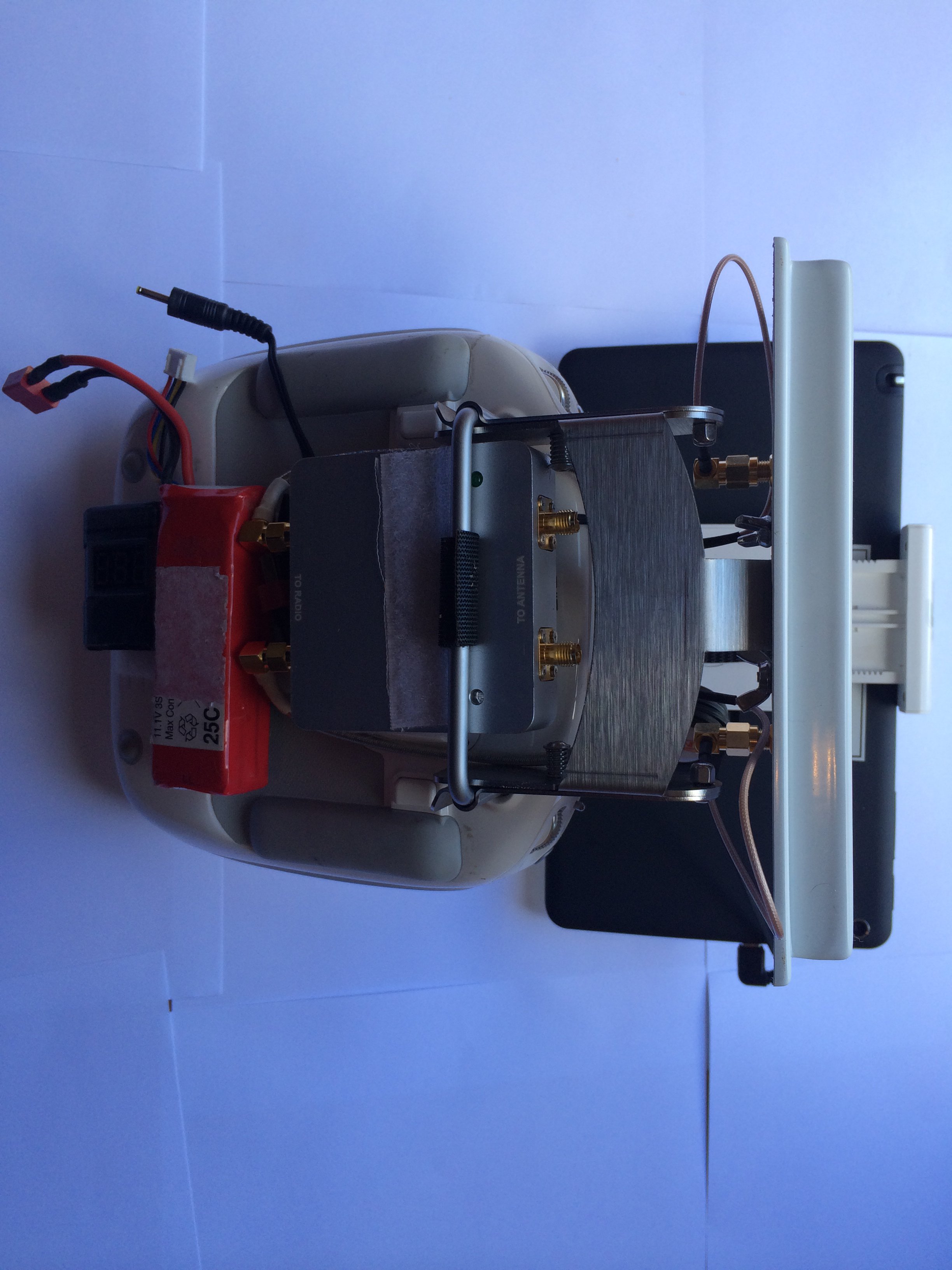

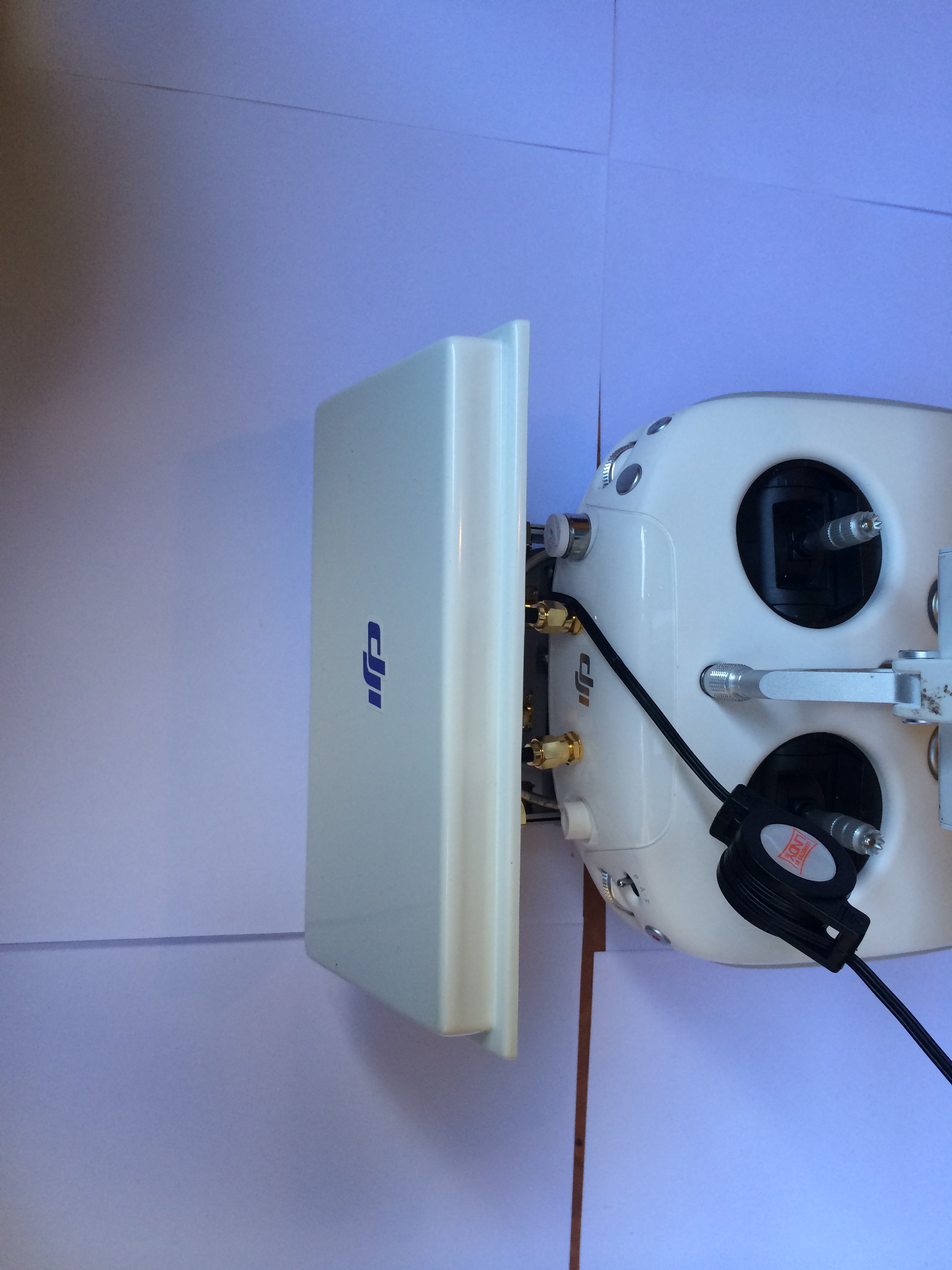

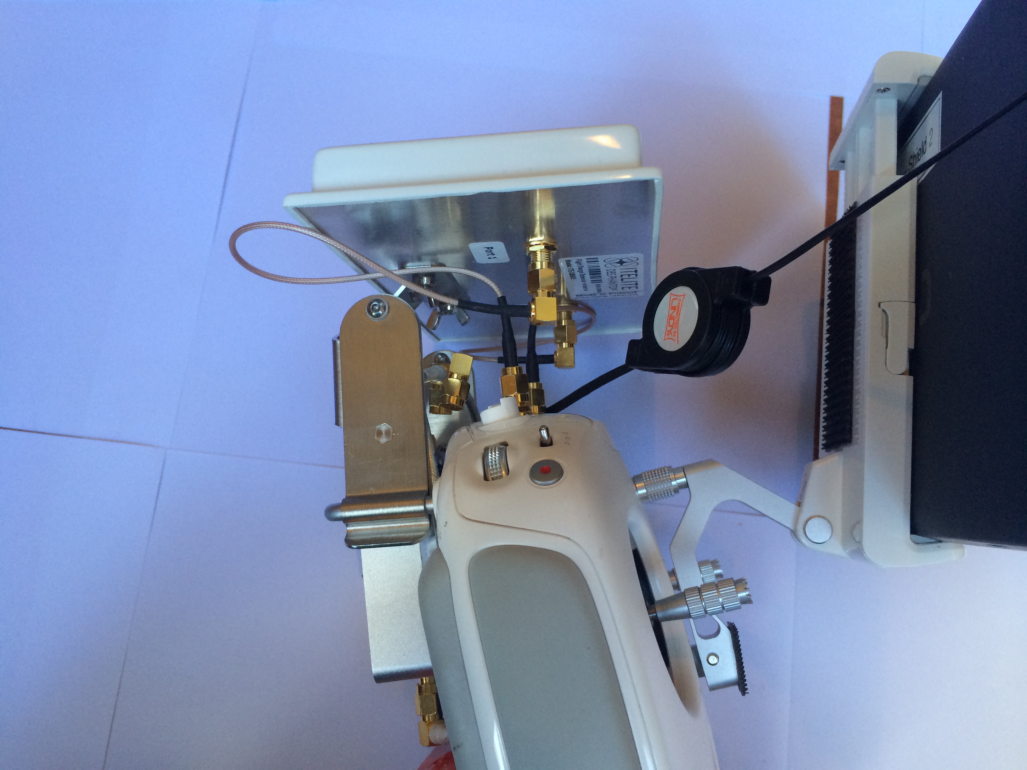

    Looking forward to flying the P3 with the new Itelite P3 2.4Ghz Antenna
    The quick mount is absolutely gorgeous
    It is beautifully engineered and a snap to install
    I have mounted it on my Handset with a amp that is already installed
    I hope to fly it without amp and then with the amp. I have done the battery mod and get 25 minutes flying.
    The British weather is pretty rubbish at the moment with 25mph gusts - so waiting for an ideal oppertunity to launch flight

    No boosting or amps. The amp was on before. I have taken it off as there is no point. This antenna does not need a booster. It is compact and now fits inside my rucksack without disassembly. The handset is so much easier to hold without the weight of the amp, battery and battery monitor. It is now compact and simple.
    Also the antenna direction did not appear critical as I did not concentrate carefully as signal was so strong. This is a bonus as direction was so critical before

    Alex - the general release looks exactly like what I got. Superb quick release mount. Little 'wing' nuts to mount the panel onto mount. You can take it part in seconds and reassemble it. Professional manufacturing
