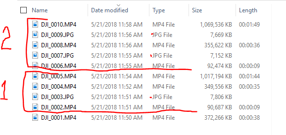

OK, I'm back from testing. The bottom line is that your suggestion of using a delay worked... 3 out of 4 times.
Here are the details:
I created a simple waypoint mission in the Litchi Mission Hub.
The mission has 7 waypoints, with a Take Photo command at Waypoints 2 and 5.
I ran the mission twice.
On Mission 1, the photo was taken at Waypoint 2, but NOT at Waypoint 5.
On Mission 2, the photo was taken at both Waypoints 2 and 5.
I ran the two missions one right after the other, with no changes. I didn't even power down to change batteries.
Actions for Waypoint 2 and 5 are identical:
- Stop recording
- Stay for 4 seconds
- Take photo
- Start recording
Richard, I see you are a retired physicist. I'm just plain ol' retired software developer and IT flunkie. When I used to write software, my fellow employees would sometimes complain that a program worked one way the first time and a different way the second time. I would tell them that, as long as the software did not change and the environment was the same, the program is not capable of behaving differently on two different runs. We would usually discover that the user thought the result changed but didn't, or else the environment somehow changed. That must be what is happening here, but I really cannot imagine what changed between Missions 1 and 2.
The good news is that I'm getting more comfortable with Litchi every time I use it, and overall, my results are starting to look more like what I imagine when I create the mission in Mission Hub. Also, I always love the quality of the video that I get from the P4P. Just gorgeous! But since I am trying to run a business and do this for hire, I need to get better at Litchi and to have confidence that it will do what I tell it to do before I use it on a job.
Thanks very much for the suggestion!! I pasted a graphic below that shows the JPG missing from the first mission run.
Reactions: Richard R
- Stop recording
- Take photo
- Start recording
Keith,
Glad my suggestion helped. I, too am confused about why it didn't work everytime! Looking at what you posted, the timing seems to be consistent between the two missions, just, as you said, missing the second photo. I've never had that happen. Usually, once it works it always works. I know it's a long shot, but make sure that before you fly again that you reformat the SD card, and do it with the app with the card in the bird. And I've been locked at times in that eternal battle between the hardware and the software guys with each blaming the other when things go wrong. Happy flying.
