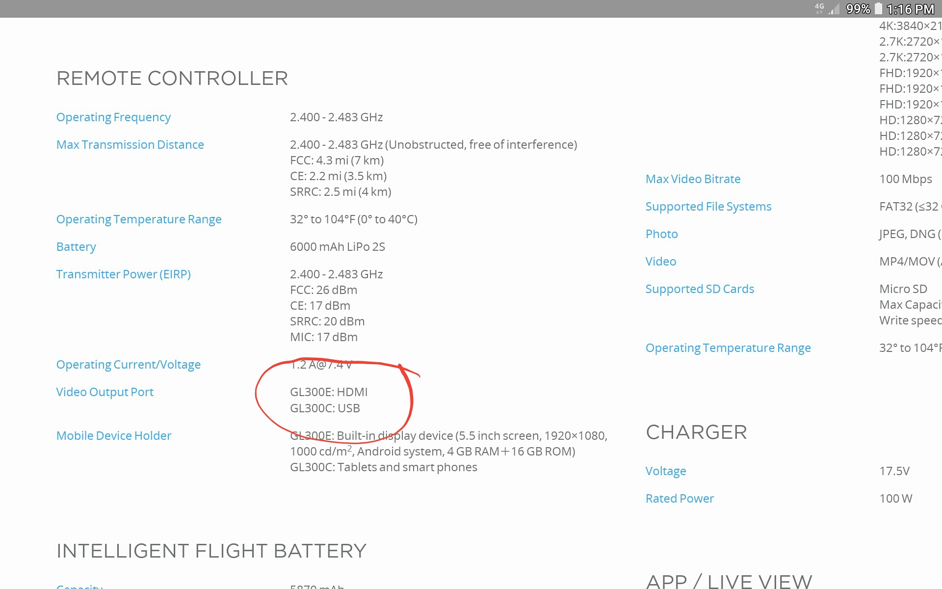

HI I use same device my awsome,,have check on transmission channels under HD to try another channel...which phantom hooked up ?,try with airplane mode on incase some interference about......my device running multiple apps and djigo go4 and litchi,,device more than capable

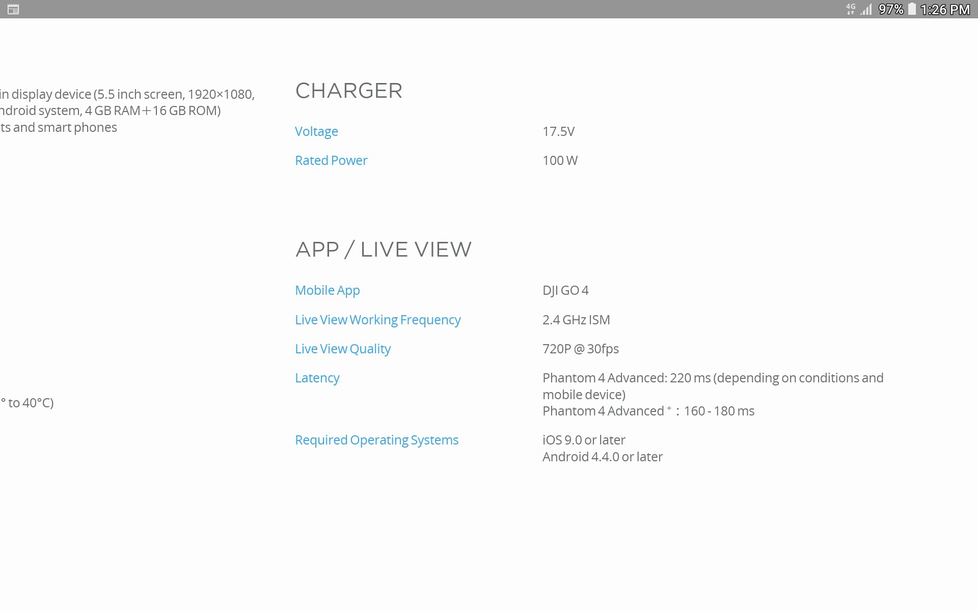

HI I was just checking some specs,,,which remote you have,,,,any change on airplane mode,,have you tryed cam setting in the bottom pic 720x30fps
