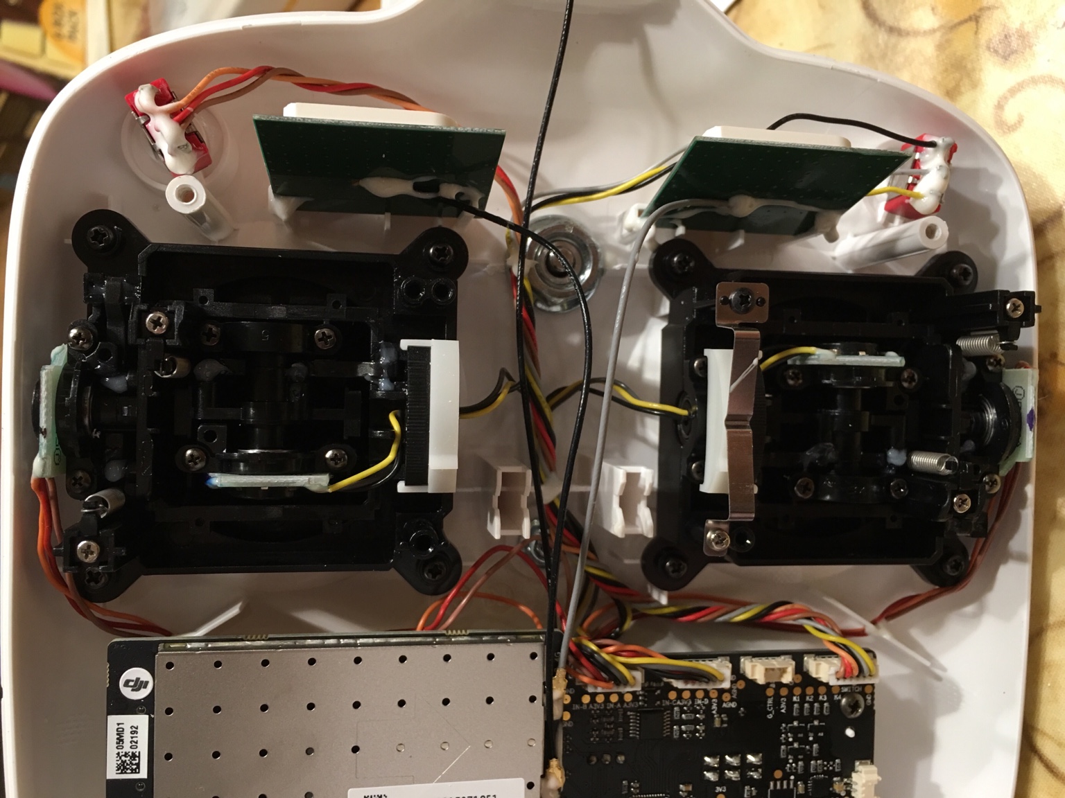

Does anyone know if the inspire mount on the standard controller will fit in the DJI backpack?
There are 3-4 wires behind that area. Go slow, use smaller drill bits first and work your way up. You'll be fine.
