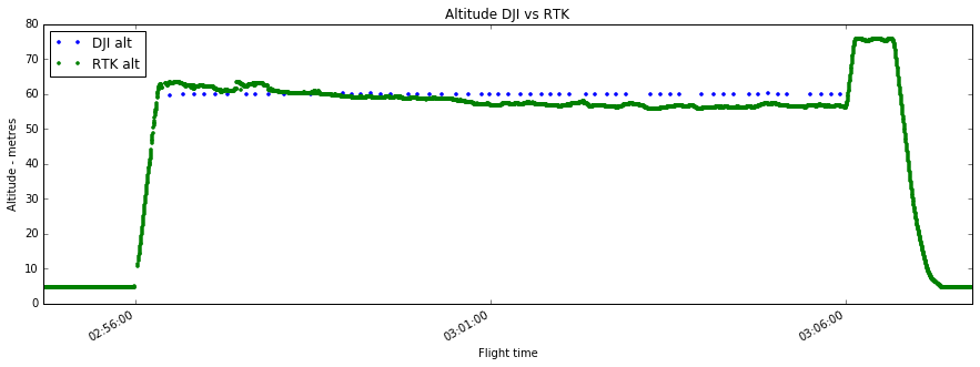

The P4 altitude drifts downwards over a 20 minute flight by 3 metres due to the sensor warming up. If you do not use GCP's or a bolt on RTK GPS then you will end up with slopes that don't exist.
I have the data to support this if anyone doubts. It was a bit of a shock. You can prove this yourself without any additional sesnor if you fly a mission with the mapsmadeeasy mappilot app and have a look at the beginning and end altitude in the log file. most missions end 3m higher than they started! indicating the drone thought it was 3m higher when it hit the ground at the end, i.e it has drifted donwwards, but thought it was at the same altitude.

I'm very surprised by how static the DJI elevations remain through that graph. Very interesting!

I know I'm trying to rekindle an old thread hear but I read that the altitude deviation from the Phantom 4 getting warmer is most pronounced early on in the flight. This graph only shows the deviation over a 10 minute interval? It would be much more helpful in my opinion to see the deviation for two flights using two full batteries over the entire length of the flight. Does the deviation continue indefinitely all the way to the end of the flight or does it slow and eventually flatten out at some point?
