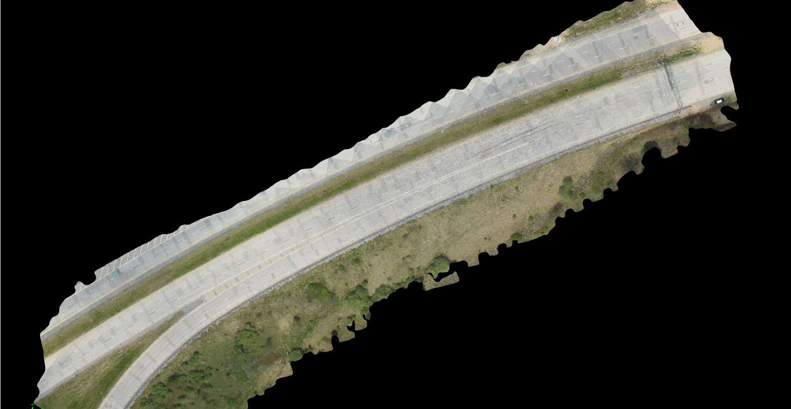

I was contacted by a Crash Site Reconstructionist the other day. He must have seen my web site. He wanted me to fly over a section of highway where an accident had occurred. He wanted me to capture images for him to load into Pix4D. I explained that I had no program to fly my drone (Phantom 4 Pro+) in a grid pattern, but he said I could fly it manually as we were doing only a small section of the highway. We were sort of learning together. That day I downloaded a free trial of Pix4D just to learn more about what my requirements would be (optimum altitude, speed, number of images, whatever else). I put up my drone, clicked a bunch of images, got into the Pix4D program and followed the prompts to download the images. I didn't know what I was doing, but I was surprised to come up with a beautiful rendering of that flight.
Next day I met him on-location, flew the mission a few times. He copied the images from my micro SD to his lap top. I took the images home and downloaded them into Pix4D. I was astonished at the result! (Mind you I don't really know what to look for regarding quality.) I flew at 125' high, used the Waypoints intelligent flight mode and clicked images as I went (about every 30' I would guess).
Screen shot of the result attached. I'd like to buy Pix4D myself, but as others have stated, yea, it's EXPENSIVE! For now my client seemed to be as pleased with my work as I was and wants me to do more in the future. He is going to buy Pix4D himself, so all I have to do is fly and click (but I would eventually like to have it myself as well).

There are quite a few, free apps out there for mission planning, and flying grid patterns. Pix4D Capture, MapsPilot (mapsmadeeasy), Ugcs, DroneDeploy just to name a couple. They are usually very easy to learn. Each has its pros and cons. But shouldn't need to "freehand" it, unless there are special circumstances. Sorry, I did not catch the "+" part of the model. Ditto what doktorinjh says.
You're fairly handcuffed using the Pro+ model, but I thought that Pix4D Capture was available for that controller. If you think you're going to be doing more of this (and getting paid for it) then you'd be doing yourself a big service by getting a regular controller and using an Android or iOS device. There are lots of free apps that will work way better than the manual method and you'll be able to keep you eye on the bird and scanning for hazards, rather than trying to time pictures. But, as you found out, the software is pretty powerful and can use almost anything, as long as you have enough imagery to work with.
