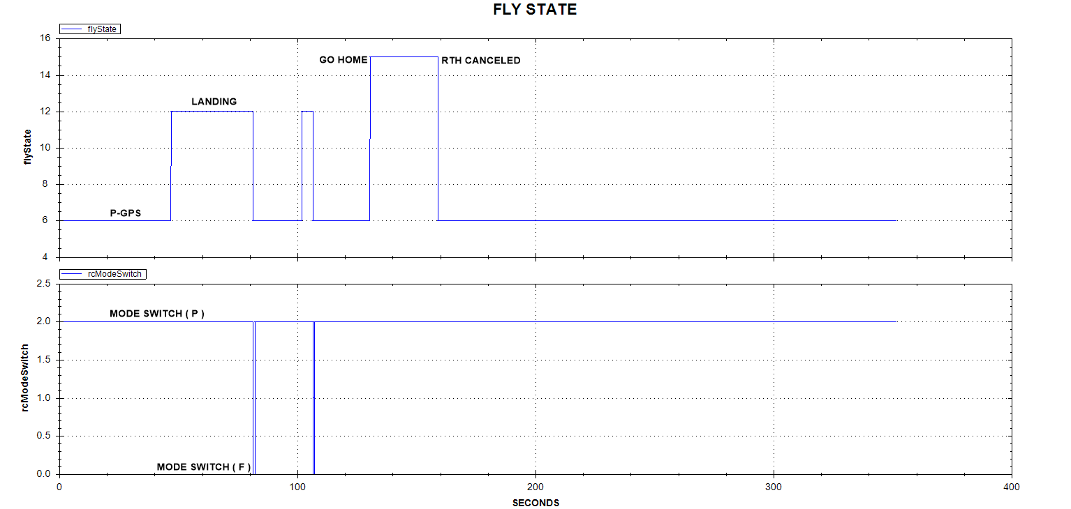

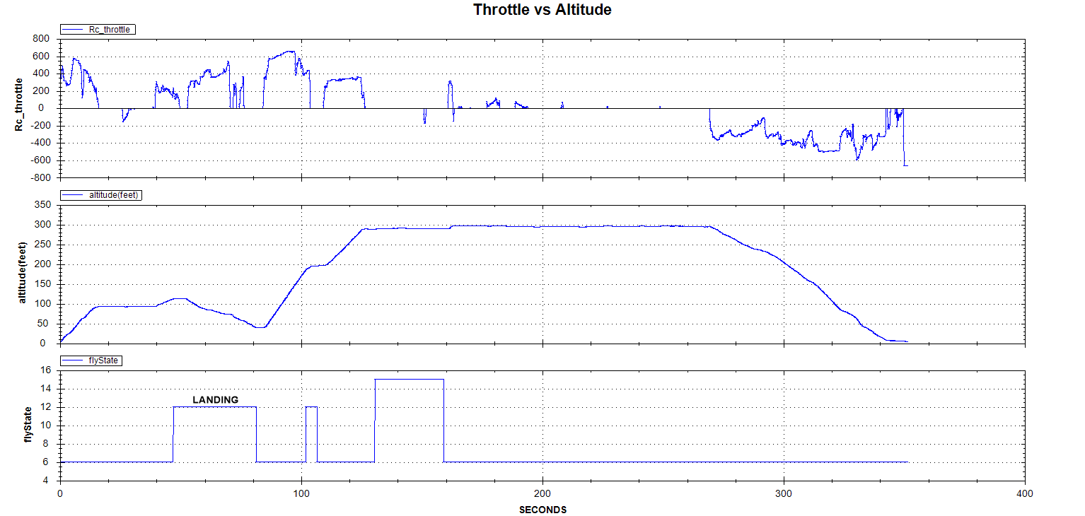

So, I took off on a routine flight, but flying lower than normal. I haven't had time to look at the flight log yet. About 1500' distance and 100' altitude, the screen had some trash flicker across it(weak signal I guess) and then the normally "green" dialog box turned blue with the dreaded words LANDING. I tried to climb, realizing that I had forgot to go to my normal altitude, but it didn't appear to be climbing, so I flipped to "atti' and back to "P", the box tuned green and I was climbing hard. I turned to head back home, and the same thing happened again. Again I flipped the switch and recovered. After it appeared to be back to normal, I hit RTH and it responded. When it was overhead I cancelled and landed. There was no "disconnected" message, or any other messages other than the audibles I have enabled, like "distance, altitude, battery level, etc. I'm sure it was caused by being too low in an area with trees, but I don't understand why I didn't get any warnings. like "weak signal" etc. I always have RTH set to return home, However I did not verify before flight this time.
I'll look at the log as soon as I have time.
