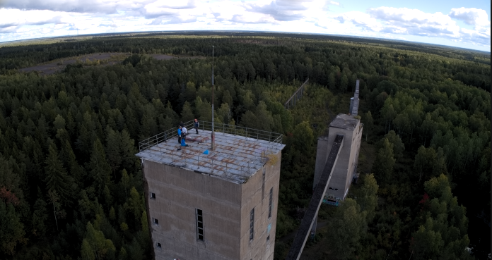

Still photo curved horizon, video straight..
not true - the software is handling the files just fine - that's what the raw files look like :)
Opening the files in Adobe Camera Raw uses an embedded profile (pre-appled to all jpegs as well) which has been discussed at length on here before
Exactly! The DNG file is from the RAW file but has DJI hand in it fixing the curve and other issues that helps lens to sensor performance. Not all guys like what they are doing. But tbo it saves us a little time and I am fine with giving away a few pixels to help the image quickly! This stuff will get better as time and tech move along too!

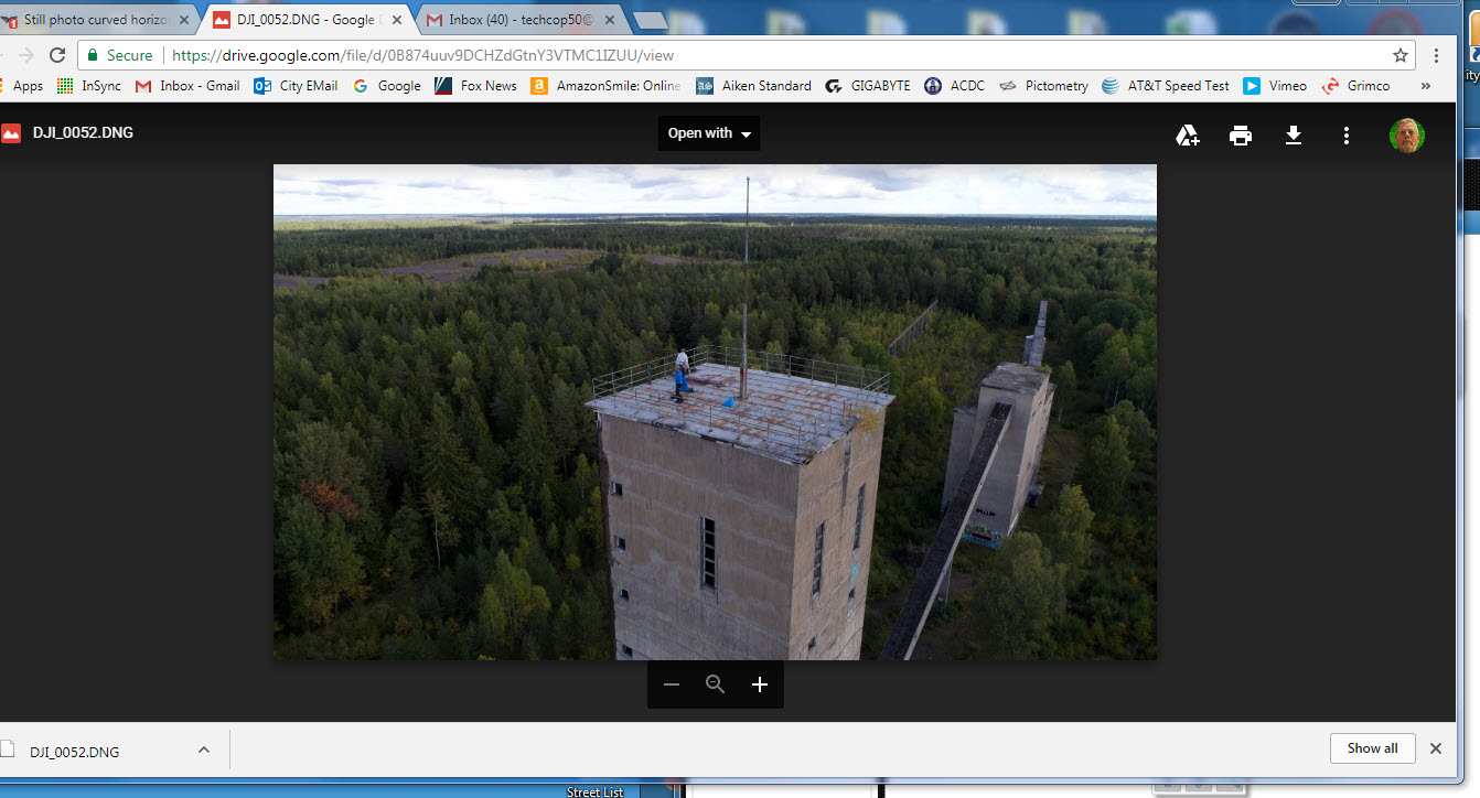

Opened fine in Windows10 default viewer...
No, wait, that's Chrome displaying it. Must be Dropbox applying the lens filter.

Windows 10 viewer doesn't display the raw file, it shows the jpeg preview which of course has already had the 'fix' applied - check the file size. windows sees the raws as 38mb 960 x 480 pixels
Interesting. So the jpeg preview is included inside the raw file?

I had no problem opening any of the files you uploaded using just my browser. No horizon curvature at all. Sounds like a driver issue to me. I'm using Chrome on Windows 10 version 1709 build 16296

Neither have I as google drive is correcting it. However in the end it appears most of the photo editors have a built in preset that fixes Ph4Pro DNG's but mine didn't (yet). I got a preset to Photoeditor which is fixing the issue.

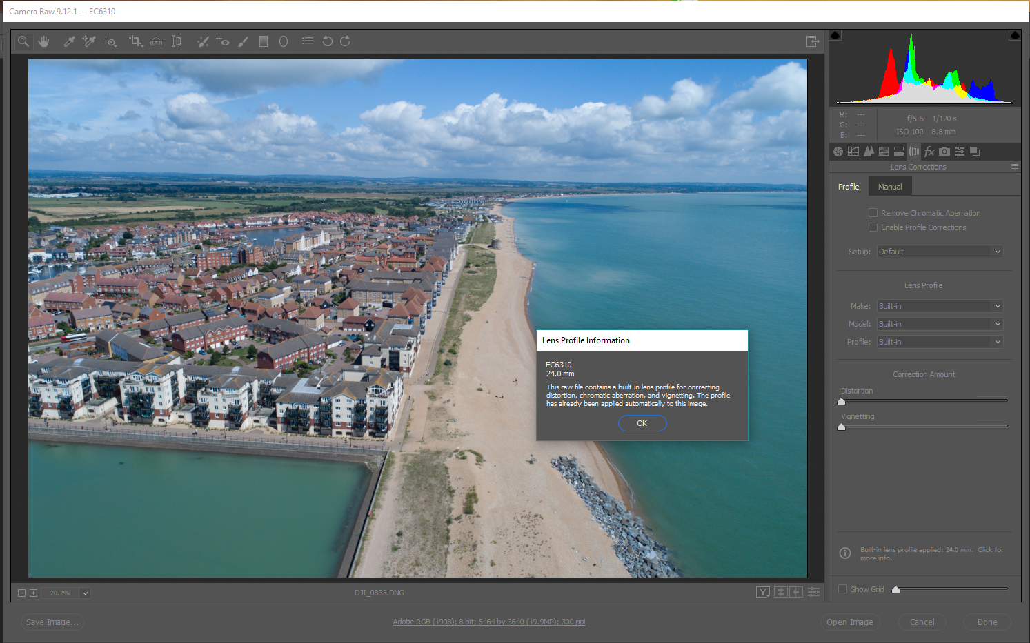

The 'issue' isn't applying a profile, it's the already embedded one that you can't easily remove if you rely on Adobe products

what I'm talking about is that Adobe products (up to date or not) will read the embedded profile which (quite crudely) corrects the curbvature and vignetting by cropping the image down to about 14mp and then resampling/scaling it back up to 20mp
In Adobe Camera Raw click on the lens tab and look at the bottom of the page

Yes Lightroom is automatically applying the correction by using the embedded profile (and you can't bypass it in LR). The lens itself is in fact not that much different than earlier models, as it still have heaps of curvilinear distortion sadly.
