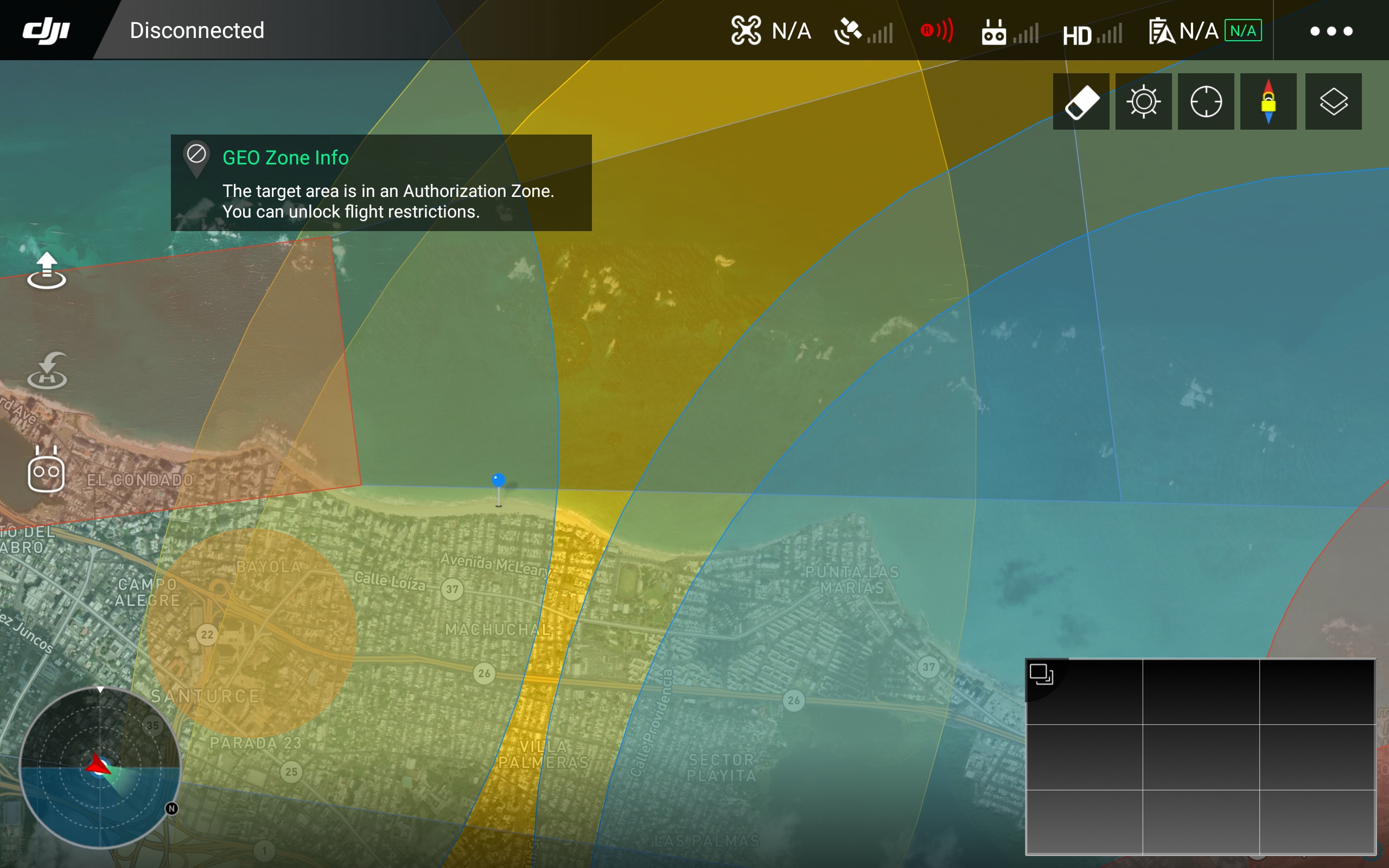

So I need to do a drone shoot in a flight path of a small airport. Went on DJI fly safe and did the authorization and was cleared. Went to do photo shoot today and DJIGO still wont let me take off? anyone have any idea what I did wrong or can do?

Put the left and right stick like this \ / to start the motors. When you do, a pop up appears in the Go 4 app saying "this place is a NFZ, you need authorization, blah blah" and gives you the option to enter the code from DJI or verify if you are allowed directly from DJI servers (requires internet connection).

You need to click the check boxes to the right of each statement. Then click OK
FYI: instead of “tip toe” you can click the auto take off icon and it will present the same dialog without spinning up the motors.
