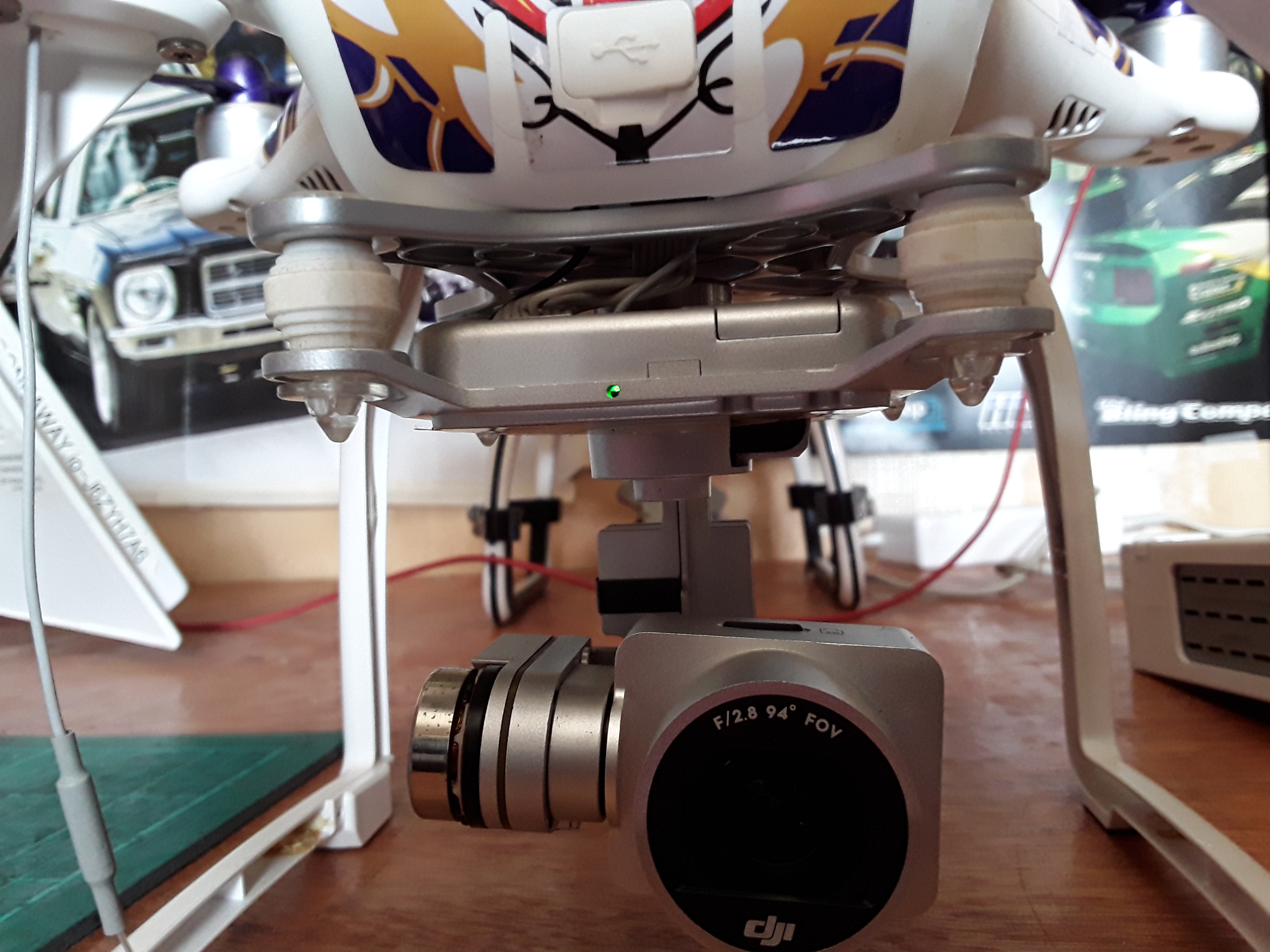

Should have nice green light on front of gimble,,it will flash red with no sd card,,all plugged up corect,cables inserted good,,could try unplug main into gimble then reconect it,,camera vibration tell me something not where it should be,was it original ribbon set you buy,,some cheap ones just do not work,,,remote got full green lights? If gimble got no light it's not powered up or not getting proper current
Should have nice green light on front of gimble,,it will flash red with no sd card,,all plugged up corect,cables inserted good,,could try unplug main into gimble then reconect it,,camera vibration tell me something not where it should be,was it original ribbon set you buy,,some cheap ones just do not work,,,remote got full green lights? If gimble got no light it's not powered up or not getting proper currentView attachment 105479
