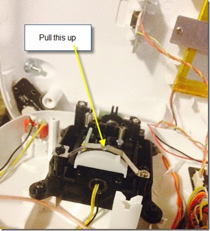

    Fix it then. I have on my P2 and my P3S . Just open the TX and pull this up a little and it's gone !
    Mod.jpg As long as that dip is over the pointer it don't lock :)

    It was a pain to me also when I got my first TX with it and was the first thing to go . Lots do like it and should keep it .

    I bent the lock on mine the instant I opened up the Transmitter case. Very easy by the way. Much easier than the P3A/P Transmitter.
