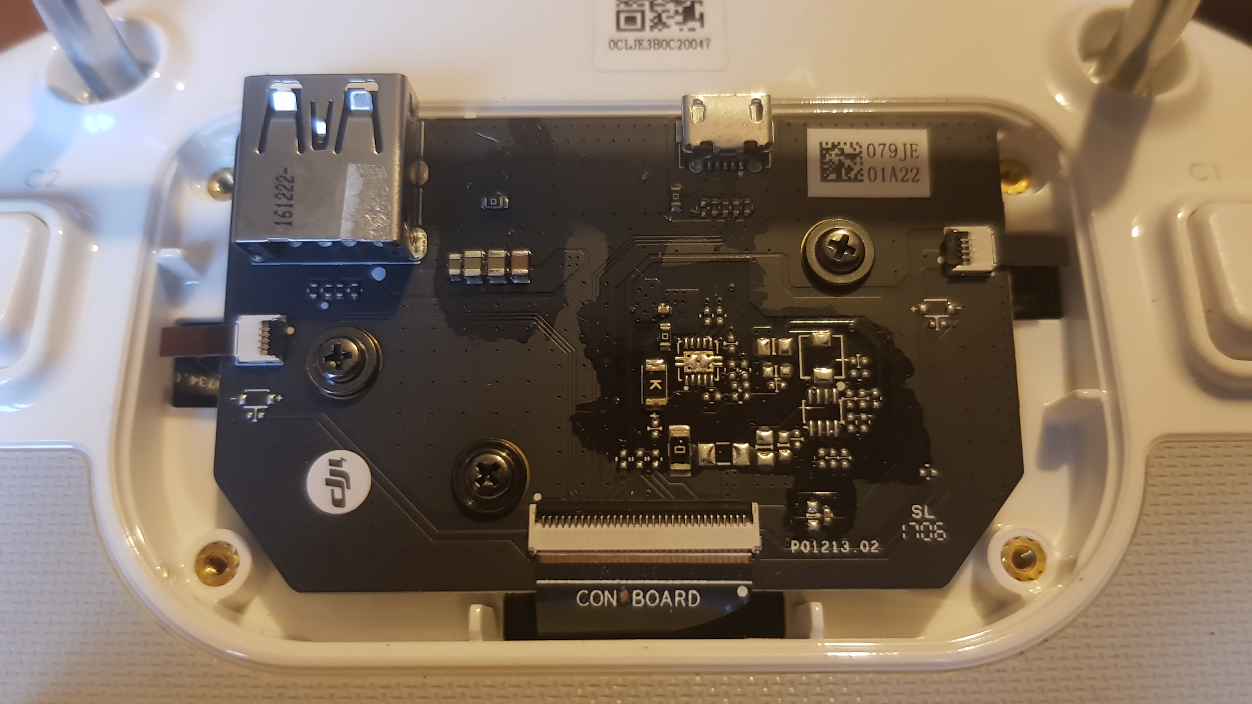

The 079JE-01A22 is that part's serial number. Just like inside your phantom you will find a similar sticker.both of the links you have suggested are from the same person and both say phantom 3 .The part numbers of all advertised boards start with 079JC but mine starts 079JE

I have just ordered the phantom 3 one you had suggested to see if that works i would rather waste the £20 than risk someones handset .

swapped the board didnt do anything i have now booked it in with DJI now finnaly give upI know it will work. I have swapped that board before. Worked like a charm.
Hi AnsiaSorry to hear it didn't work for you.
