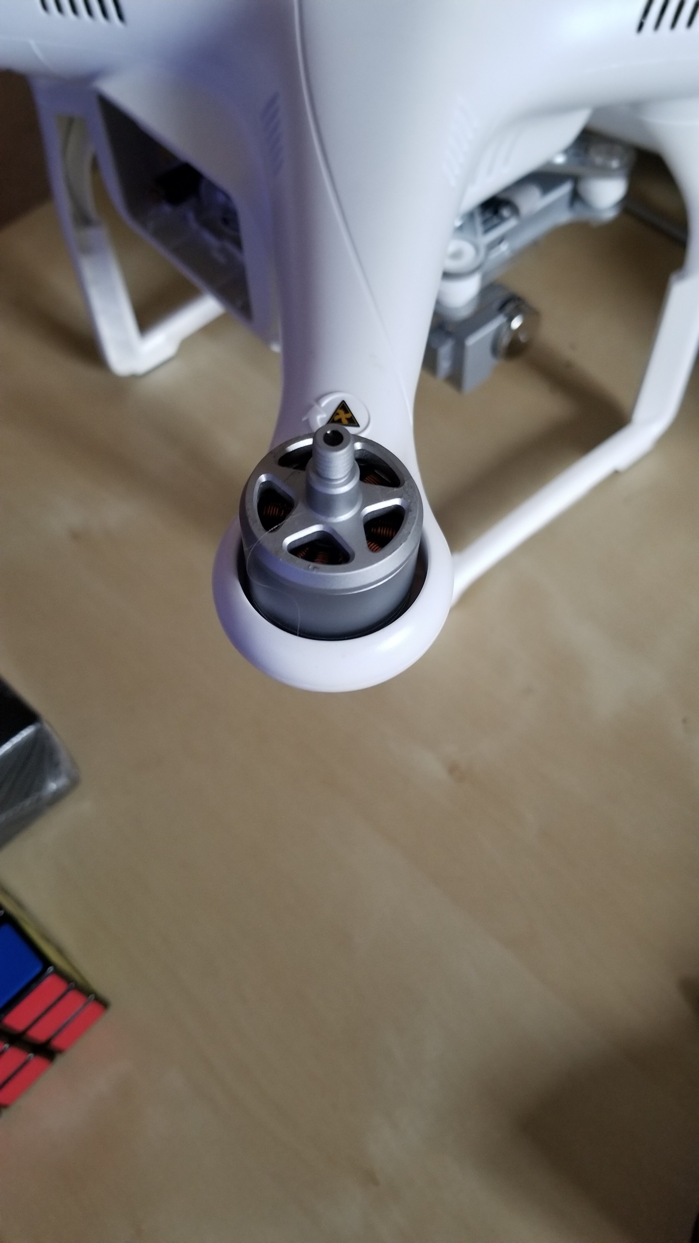

I actually found out what the issue was. there where prop gaurs installed and i took them of and put back the long screw but they were to long and messed up the wiring inside all of the motor so thats what acually cause the ESC error. I ordered 4 new motors yesterday.
The phantom 3 pro motors are the same as standered right?
Hooooo Ray ! Thrilled that you have found the problem.....And im not so sure about the motors swap... Stay tuned here and some one can provide you with that answer....Buy i don't THINK they are the same......Wait to get a confirmation Yes or a No !
BTW i have sure enjoyed this Thread!
Reactions: 3rdof5
I read that most people just replaced the motors and it worked but there were like 2 people who still got the ESC error. Hopefully mine is gonna work..
There are 2 styles of motors, early and later models
Those are the later style.
yeah i have those ones on my phantom 3 pro and i ordered those kind with the circle on the bottem cause the older model has a square thing on the bottem.
So if it says its for the standered i think it should work for my pro to because they are the same model?
Yes as long as the silver housing looks identical they will work fine
