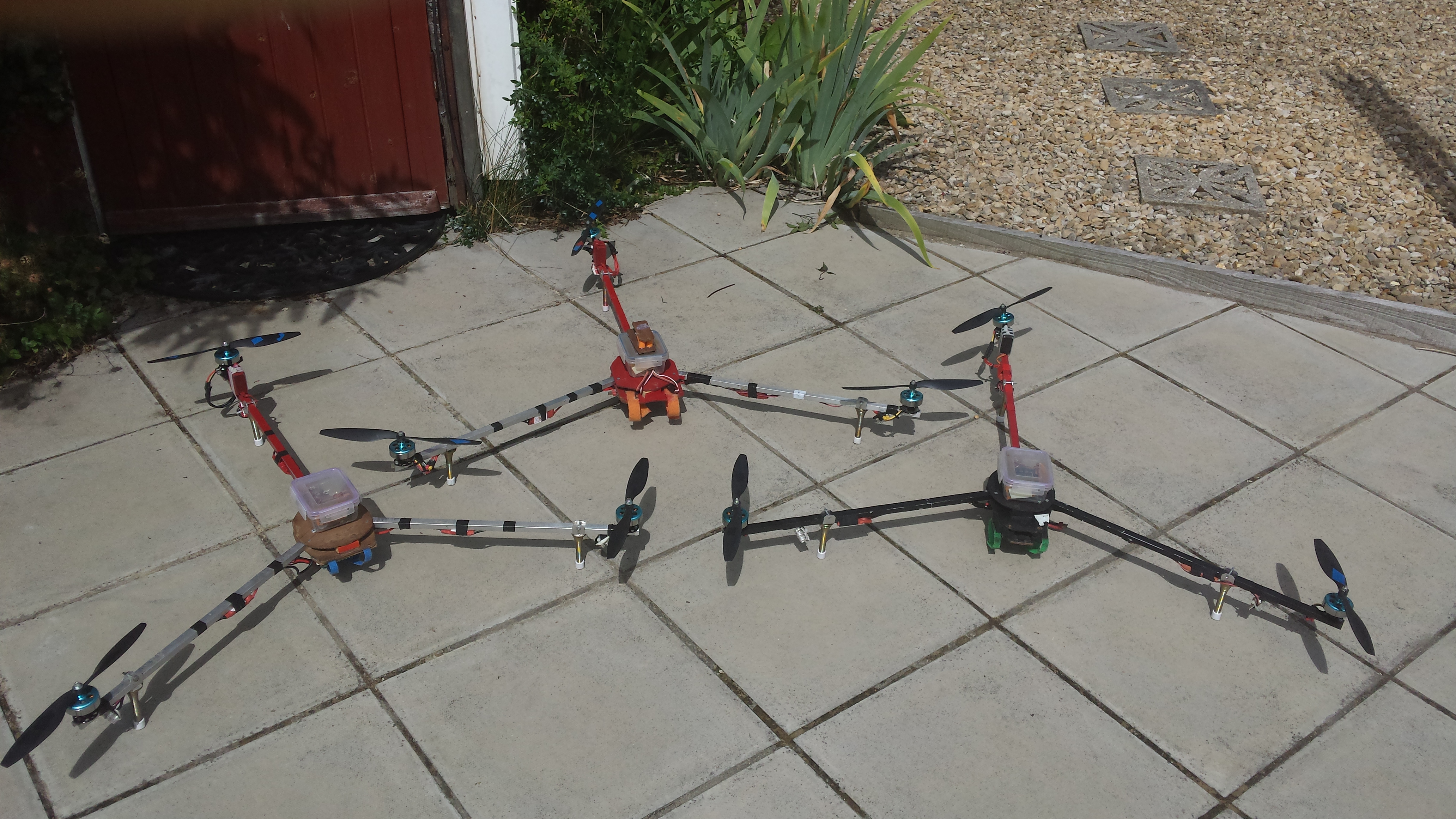

Im not a repair shop but before DJI came on the sceen I used to build quads and tricopters so I understand a little about it but oviously not all?
