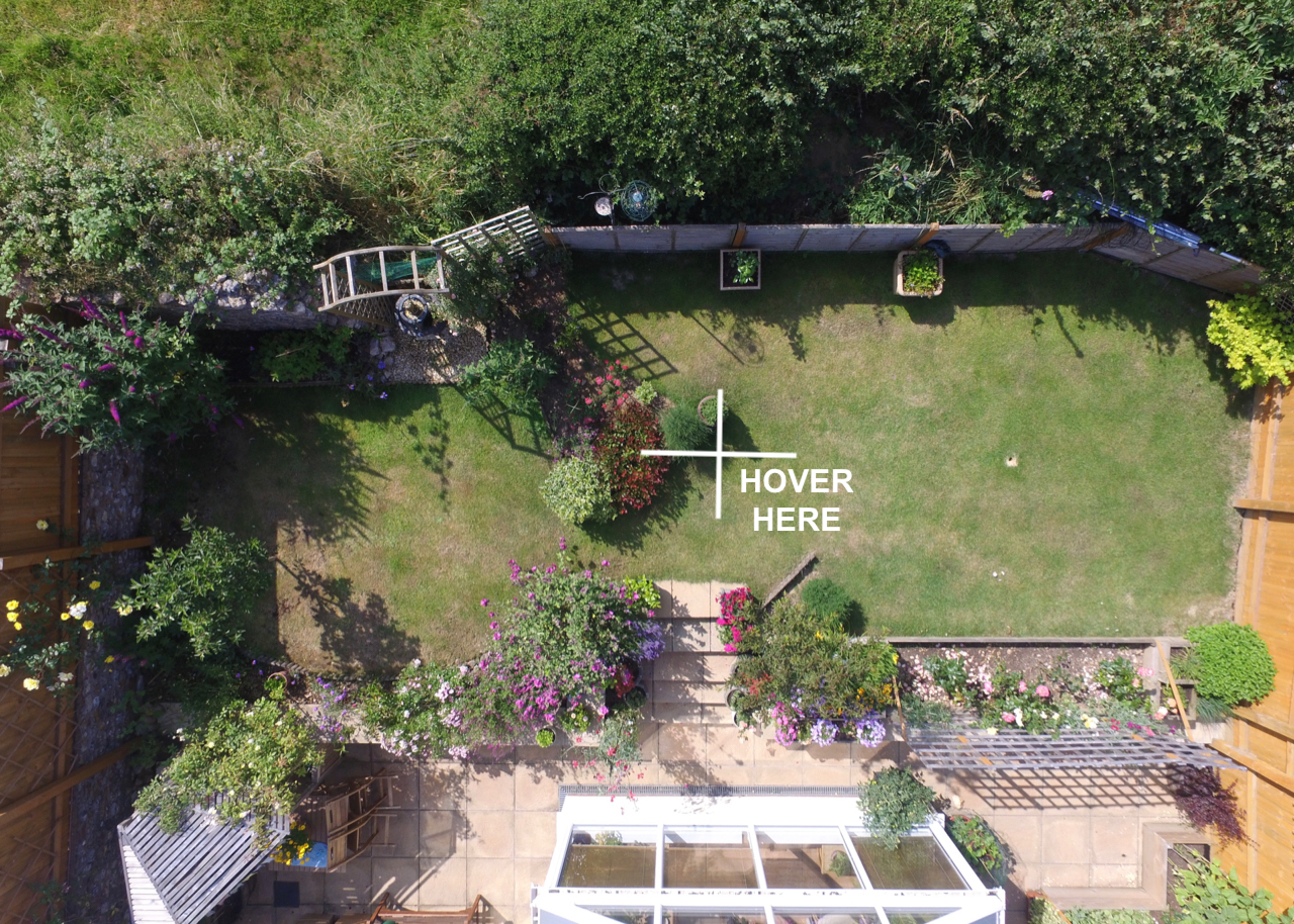

This is my little garden from above. I just thought it would be nice to hover over the little central flower bed and rotate 360º with the camera facing outwards to look at the surrounding flower beds. Practicing annotating as well :cool:
Probably the best method for your objective of a 360° view of your garden would be stitching a 360° panorama together from individual still shots taken every 45° of rotation around the hover point. You can also create full 360° spherical panoramas at different heights by adding in stills from panning up 30° and 30°, in 3 overlapping layers, plus two ground shots, looking straight down at right angles. Then, in the 360° panorama webviewing, the viewer can zoom in and around manually, and also enable a preset perfectly smooth autorotation speed, simulating the drone rotation in a video. Better resolution, and no video panning issues.
Uuum depending on the height of the flowers in the flower bed what about a square of wood mounted on a panning head on a tripod or if the tripods column can rotate directly on the tripod itself then sit the drone on the wood.......

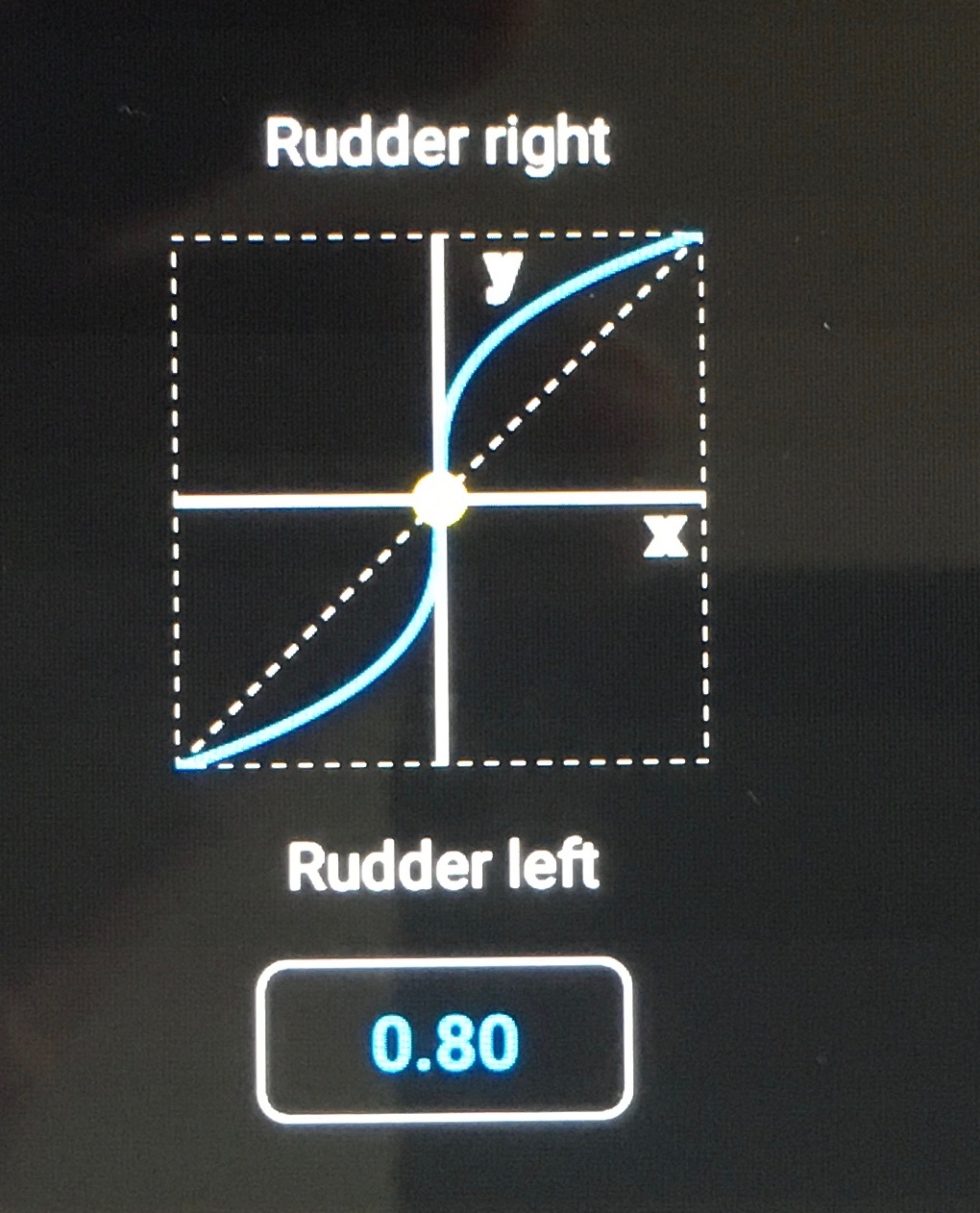

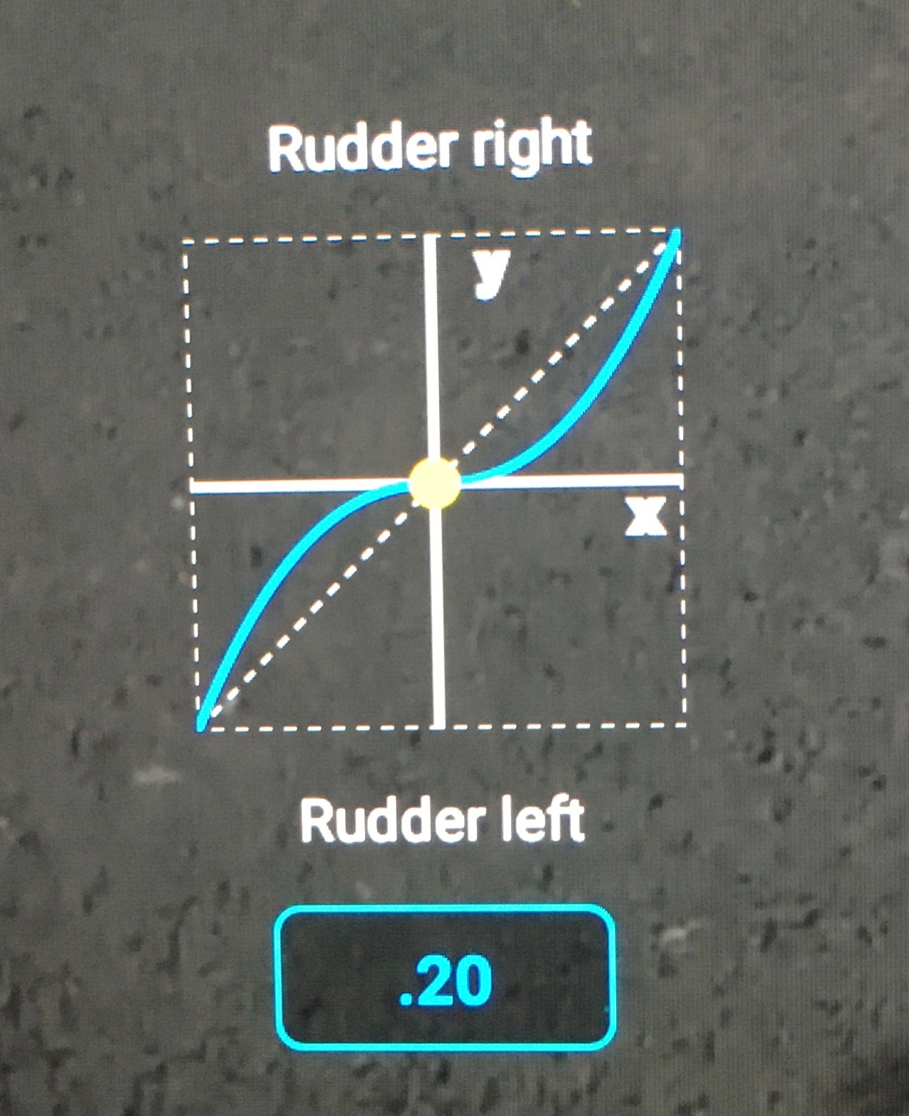

Which of these two expo settings will give rotation for the least amount of stick movement, ie slowest?

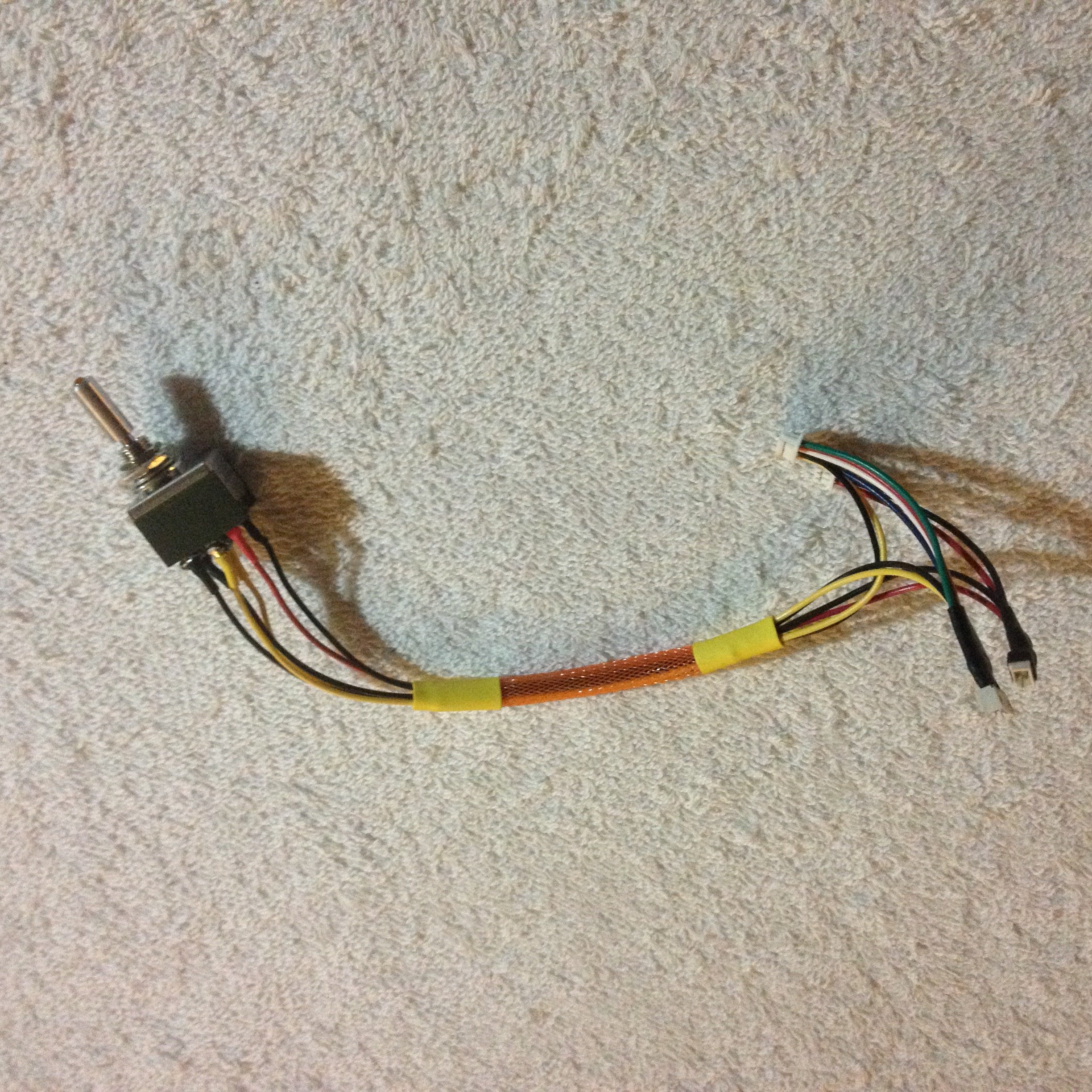

Ok ,we used to have a member here named J Dot that made slow mod switch’s. It cut the spin way down. Do a search for slow mod
and you will see what he was using . Now these were in P2’s but
you might can get an idea. He made those switches and I got several of them used them and they worked great.
They were not vearable but it helped and then change your expo‘s slow.
Heres another guy. http://www.phantompilots.com/viewtopic.php?t=23497
Thanks dirkclod, I'll investigate.
OK, investigated, looks interesting. I believe you have one of these switch arrangements ? Where are the resistors, must be switched into the yellow Leeds I presume?

I moved the Expo to .20, slowest setting and used my thumb to nudge the stick and did manage a much slower pan, but it was very windy so very uneven.

I’ve sent emails out to ( Michael ) , and am digging for other tech specs on the mod, to help with his build! I even have an old kit for my last version switch I built ( offered to him for free! ) requires assembly, but may help with understanding the Tx and how it operates, always better when YOU build it yourself! Then you can diagnose issues with ease!
