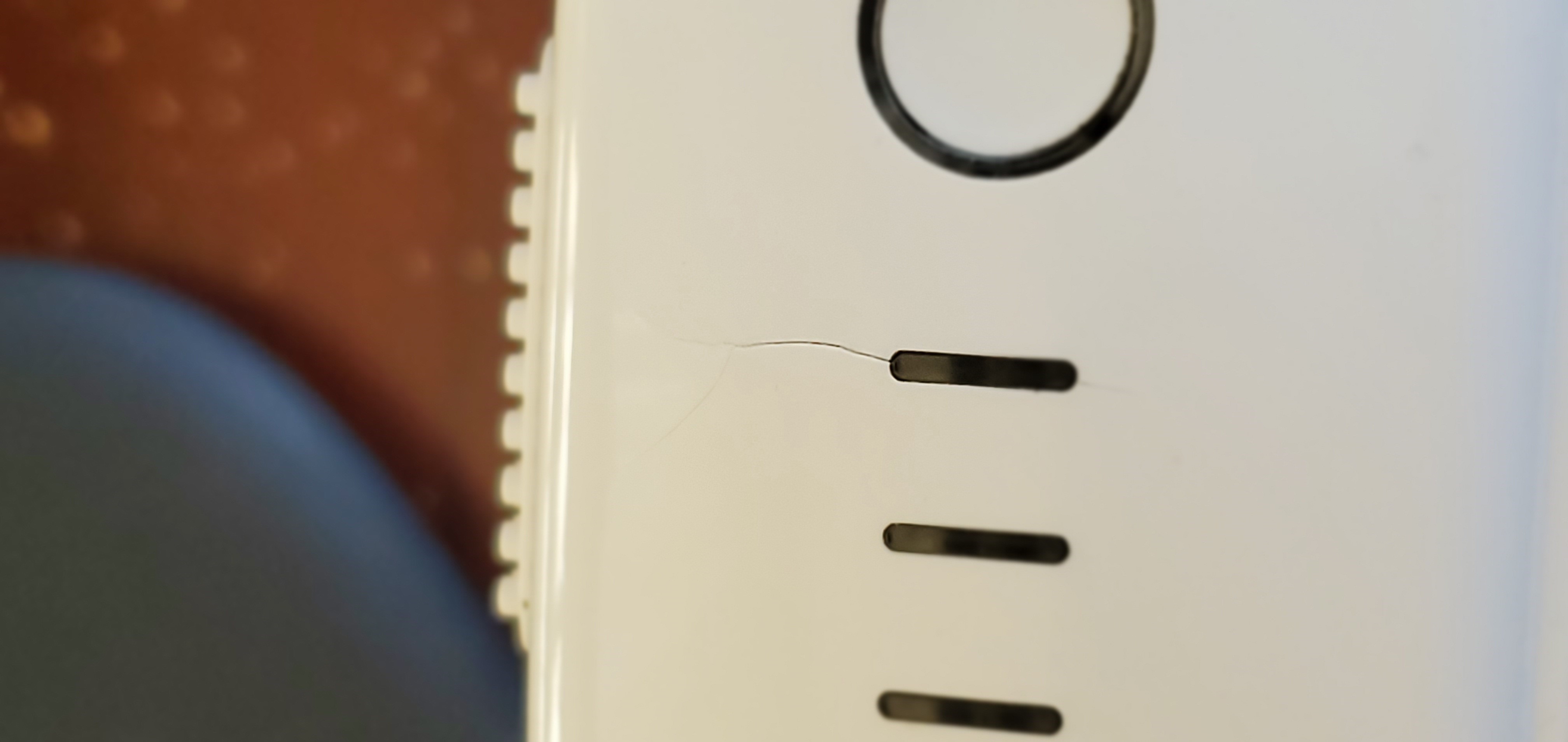

My phantom 4a never been crashed or dropped, but I just noticed a small crack on the battery, Should I be concerned, Everything reads fine on the battery

The battery cap just doesn't have enough reinforcement for the pressure that is put on it. Many are like that. The battery could be compromised and not stay strongly seated in the drone while flying. Some have tried to help reinforce it by taking the cap off and epoxy it. Don't take off forward fast. It might eject the battery. It's your call.

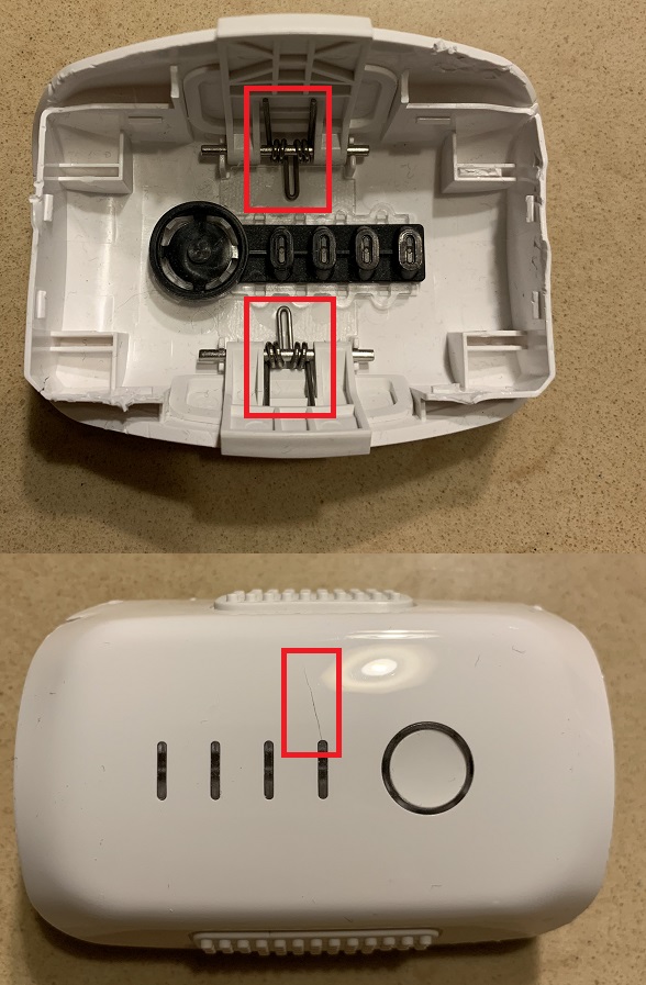

This is a common issue and it's due to a bad design. The springs on the inside of the battery cap place more pressure on the top than it's able to withstand.
Hi and thanks for sharing this info. Both of my batteries have developed cracks in this area and they do indeed appear to be the result of pressure from within.

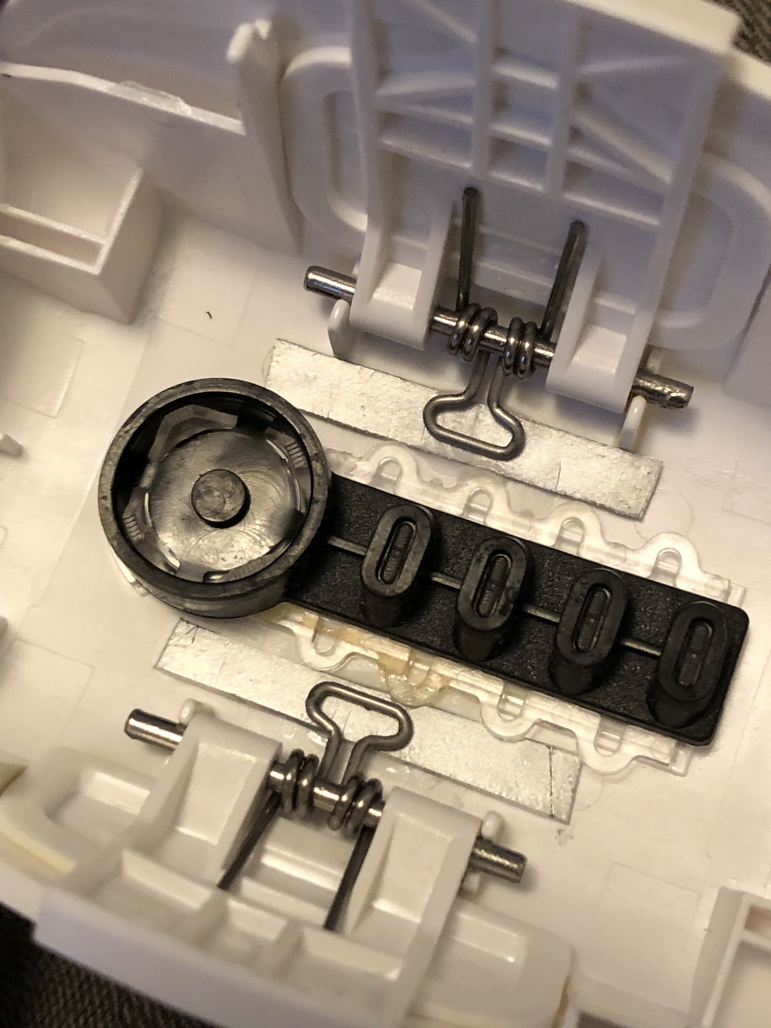

I installed a small and thin piece of aluminum to spread and reduce the pressure of the spring on the cover

It must be about 2 years now that I glued cracks in the battery and the craft with Locktite 414 and all the cracks have not expanded all is solid. I tried other types of glues with not so good results but the 414 works very well with this plastic.
