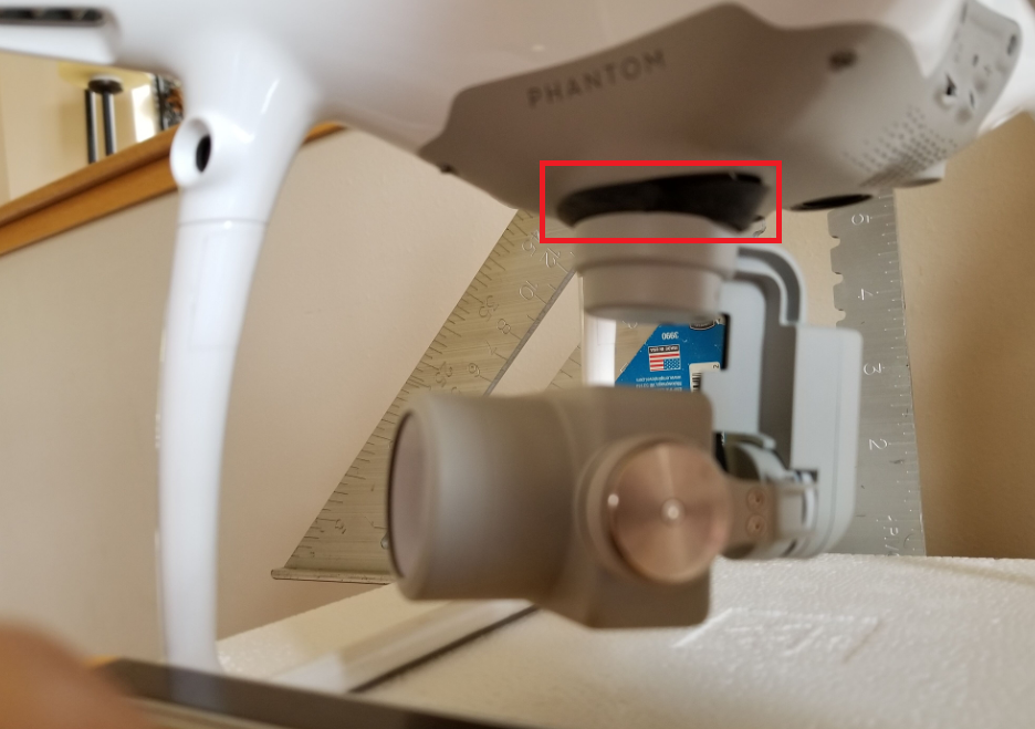

Another link is a picture of the camera/gimbal of the drone. 20190519_134356.jpg
The yaw arm might not be bent, but the gimbal is definitely falling out of the drone body. You can see that here:
111364
