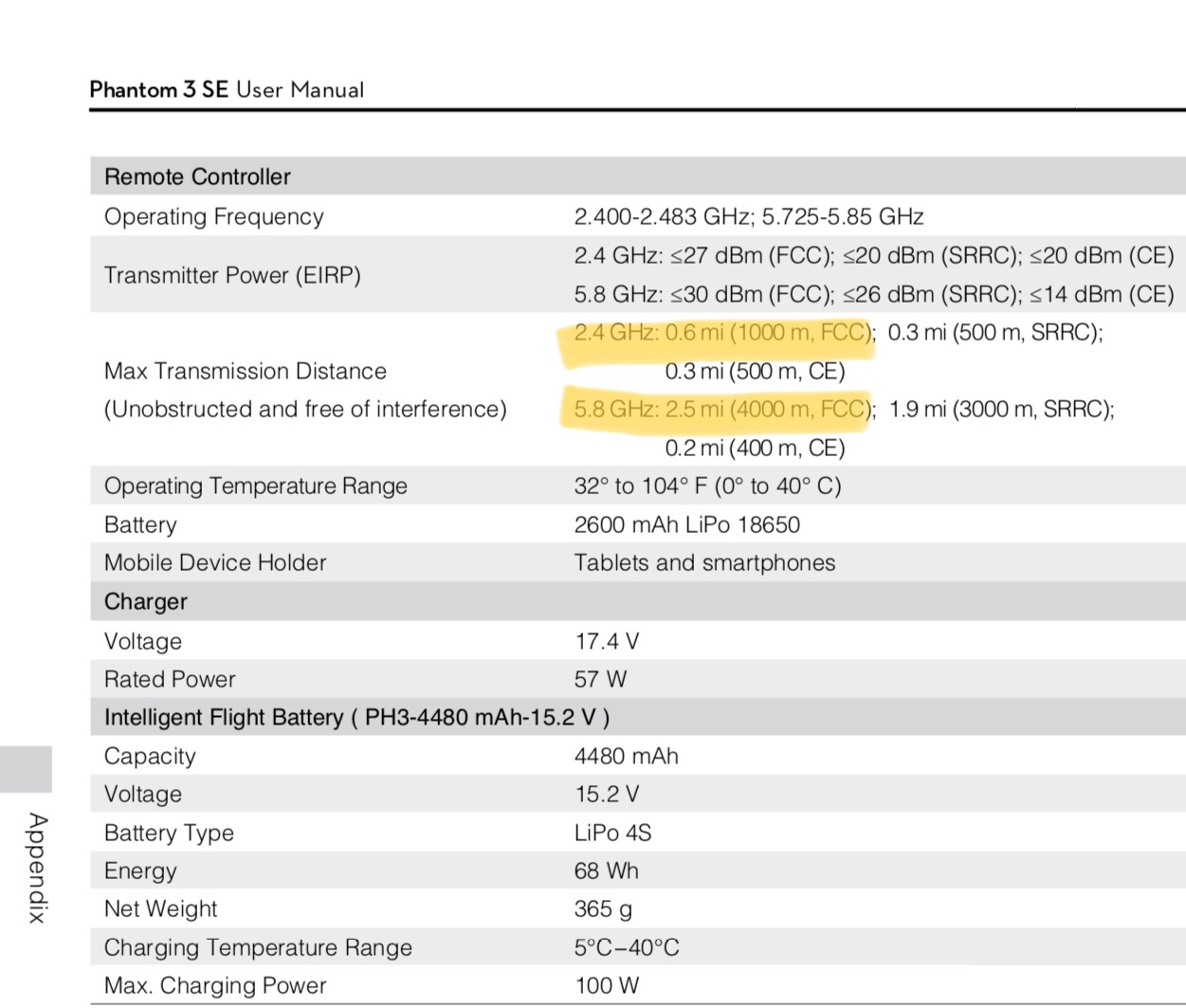

Look at the manual : if your are in fcc mode it may travel 1k in 2.4 or 4K in 5.8, but if you are in CE mode it only travels 500 mts in 2.4 and 400 mts in 5.8.

you can if your device allows! check your device's performance and if you have what I will show in the picture you can!
