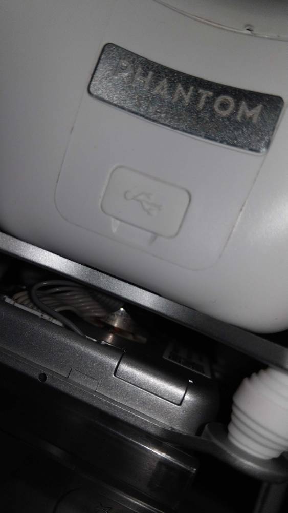

Well it gets very weak
Also my signal is very very weak
Idk if I connected this properly
