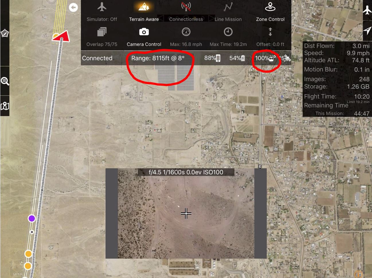

Here's a definitive answer:
Install and KEEP this software/firmware combination, and your P4P will fly rock solid for the rest of its natural life:
App: v4.0.8
Aircraft: v1.3.509
Remote: v01.04.01.00
Precise Fly Safe database: v00.00.01.04
Basic Fly Safe database: v00.00.01.04
Turn off all the Object Avoidance crap and leave it off. Install the 32 channel hack and always run it in "Custom" mode. If you fly, and you get dropped frames, change the channel. Channel 31 (2.4GHz) seems to work very well around these parts (not a single dropped frame in the mission below). For short-range missions, I use 5.8GHz.
Our 3 P4P's fly very predictably and have been solid as a rock.
