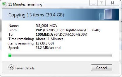

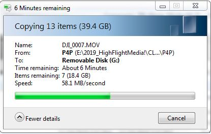

Hey doods;

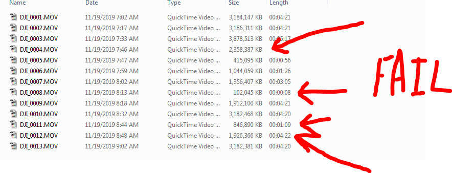

I have TWO of these SanDisk Extreme Pro 128GB MicroSD cards that I use in both my P4P AND my Hero7 camera. I seem to have problems with both cards in BOTH devices. Seems the 128GB cards are the common denominator. Either recording stops completely and erratically, or the bitrate gets throttled down to 2/3 what it should be.

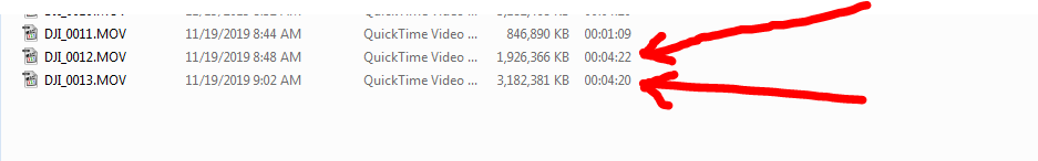

Here's a screen capture of a shoot I did today. The bird randomly stopped recording 4 times. And you'll also notice - despite equal length files - the file sizes vary greatly. This is due to a lowered bitrate that happened quite randomly.
Notice these two files of greatly different size, but almost equal in length.
Anybody else having problems with these cards?

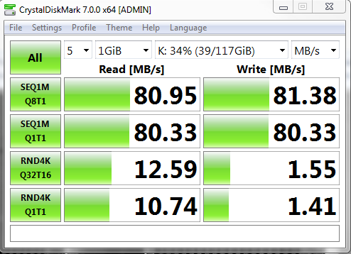

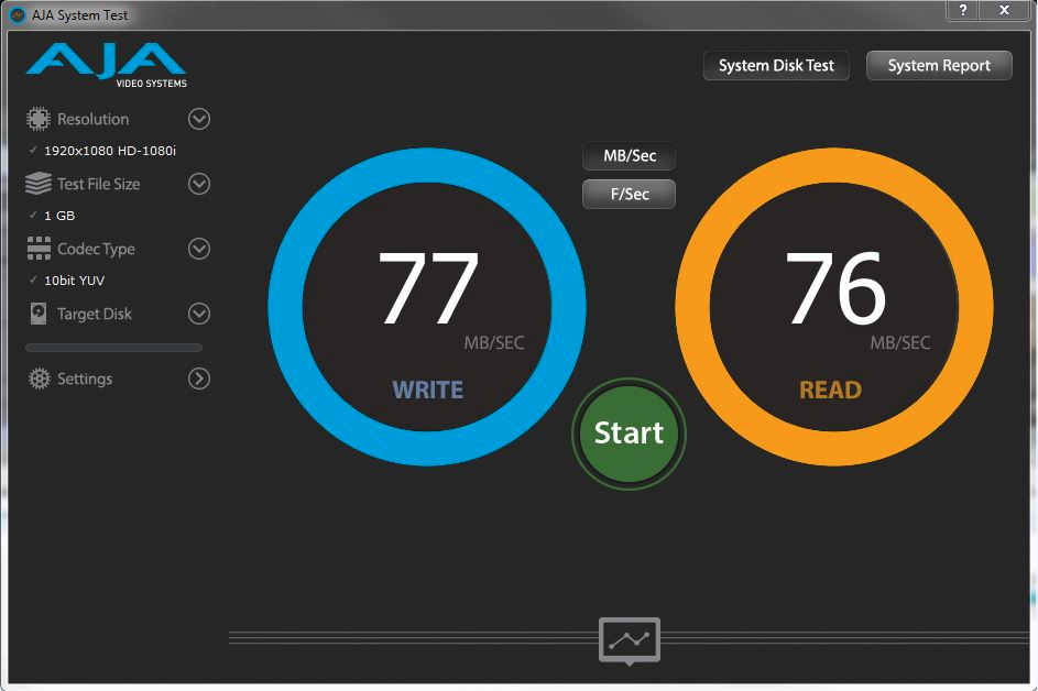

I just picked up a pair of 128GB Lexar cards from Amazon, but they don't seem to be living up their claims. Despite claims of 270MB/s read and 150MB/s write, benchmark tests are closer to 80MB/s:
I reached out to Lexar to confirm that these are genuine Lexar cards, but I'm pretty sure they are, as counterfeit MicroSD cards rarely break the 20MB/s benchmark.
In real-world write tests, the Lexar did even worse.
Worth noting, these benchmarks are actually SLOWER than the SanDisk 128GB:
These tests were conducted on my video editing machine (which is a monster) via the USB 3.0 port via a Transcend USB 3.0 card reader.
What kind of benchmarks are you seeing with your Lexar cards?
UPDATE: It seems that in order to achieve full read/write speeds, one must have a DEVICE that supports the new UHS II standard. Neither my GoPro Hero7 Black camera nor my Phantom 4 Pro support these standards. Maddening. So today I'm going to simply try recording for hours in both devices to test reliability of the new Lexar cards.
