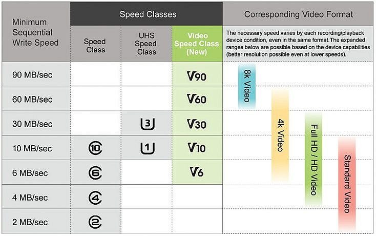

Ansia, you come up with the best stuff! I see there will always be better and faster. What I need is adequate! Here's what I got:
Reactions: Ansia
The good thing about charts like this one is they show write speed which if often not advertised by manufacturers. Manufactures normally promote read speeds.
The P4P v2 writes at a Max Video Bitrate of 100 Mbp/s (12.5 MB/s), so higher write speed cards for a P4P v2 are generally more important than with the slower writing P3 models.
