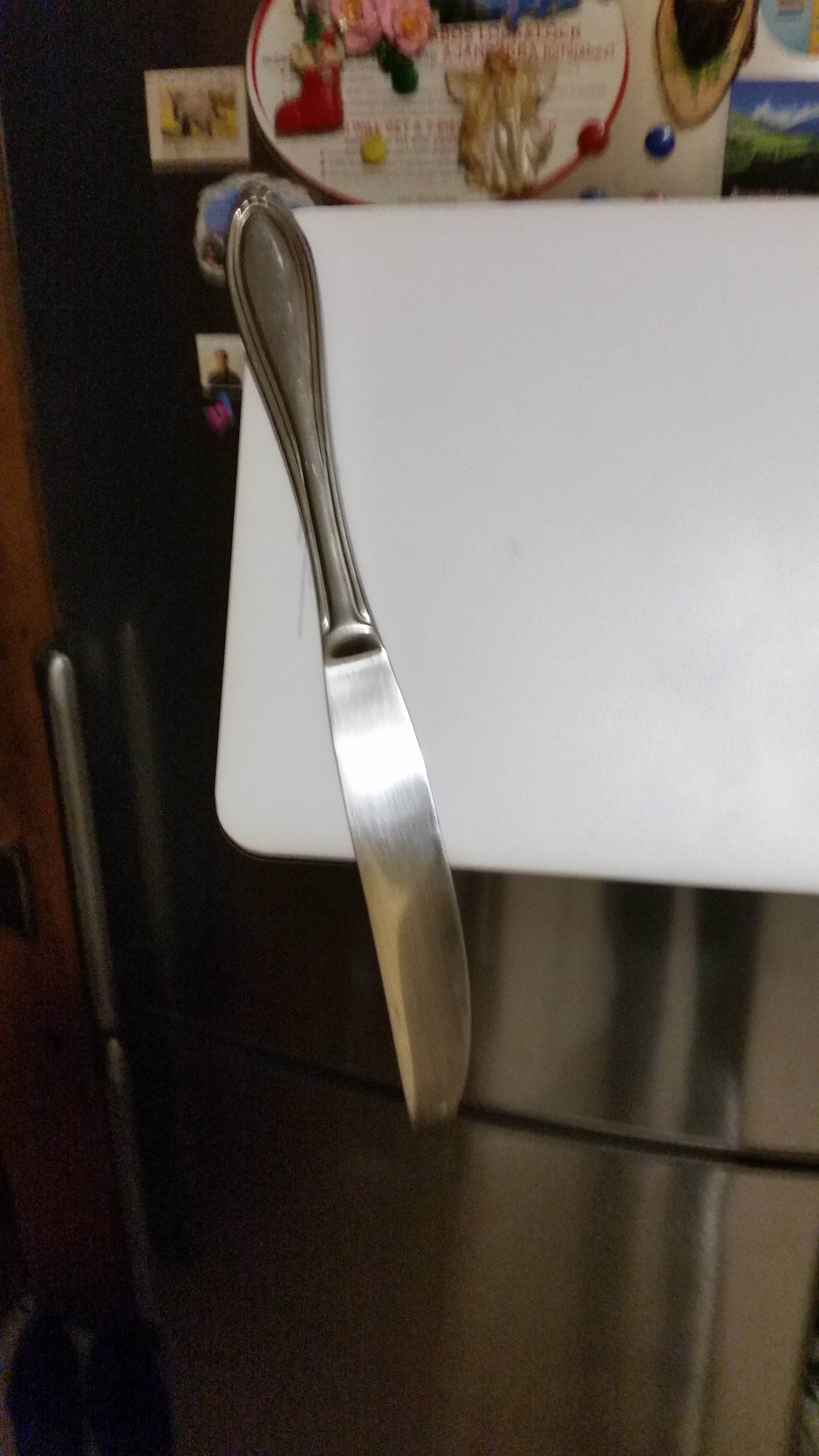

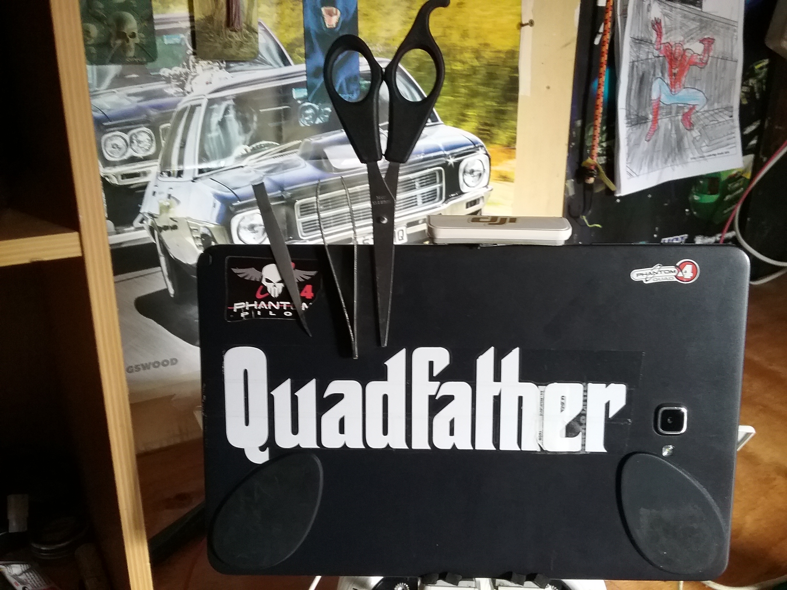

Well, this thread it is pretty old, but i am the owner of a Galaxy Tab A 2016 too, and i have signal issues... As i tightened the tab holder screw a strong magnet from the back of the tablet grabbed my screwdriver ! So i believe this is the guilty regarding the signal issues!
The tab works great, today i got the Oreo update and it is more smoother and stable the OS, so i won't stop to use it, i will try somehow to remove the magnet, because i don't need it...
Typically there are no magnets in the tablets themselves, the magnets are in the cases, so if you are using the tablet in its case try removing it. Also a tip for improving video quality and lag is to turn off wifi and in the go app turn off cache video locally. That will decrease the load on the tablets cpu.
Well, this is an exception :) I attached a photo, but @ianzone in this thread also attached one, worth to see that one too :D
The Tab A is octa core, i believe he well manage the cache, but will see when i will finish the rebuild project and get back in the air :)
Wow i had to see that to believe it!!
