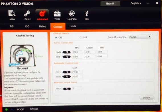

Sorry Intruder as I was just re reading here and saw I had missed this but here is where I have mine right now .
At the bottom where I have mine at 5 it is normally 10 and don't know if it goes faster [above 10 ] as I have never tried .
Just delete what's in there and try a higher number and don't forget to hit enter and see if that helps ya !!!

Thanks Dirk. I thought that is what you were referring to. And I've tried changing the values, but nothing seems to change the speed of my CNC china gimbal. It is slow, probably as slow as using the app. I know it can move faster, because it does when compensating for flight inputs.

You can play with the #'s and watch where your camera goes to see just what you want while still hooked up .
I play with those numbers sometimes just to see what it looks like when flying . I like to see the props in some of my pictures porkey ! ;)

I made some discoveries while looking over your post. First, on the CNC milled China Gimbal, changing the manual speed setting has no effect. Either to 5 or to 100 (the max input), manual movement stays the same. Or well, must be in the software settings. Not that important to mess with to me.
Then I noticed another difference in your RPG settings versus mine: Your Automatic Control Gain settings are at 20. With the China it HAS to be set to 0 otherwise you would experience overcompensation. It took me two days to figure that out...
Finally, the servo travel limit settings are different. I have to set mine at 900; 0; -250 to have it point high enough and avoid most arm and rotor view in the footage, and to show straight down. So, that is also noteworthy...
