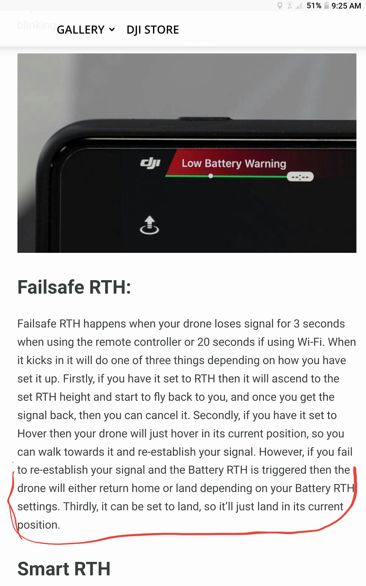

what is this battery return to home setting???
That's where you have your first batt warning and then critical batt warning,,example,,mine set 30% first warning & second critical warning at 10%,,,sometimes if smart return home is on . The batt can predict flight power if it can make it home again or not and could go into auto landing by itself which I had happen once,glad there was no water below

Just had look and if smart return home is off it won't go to home point
