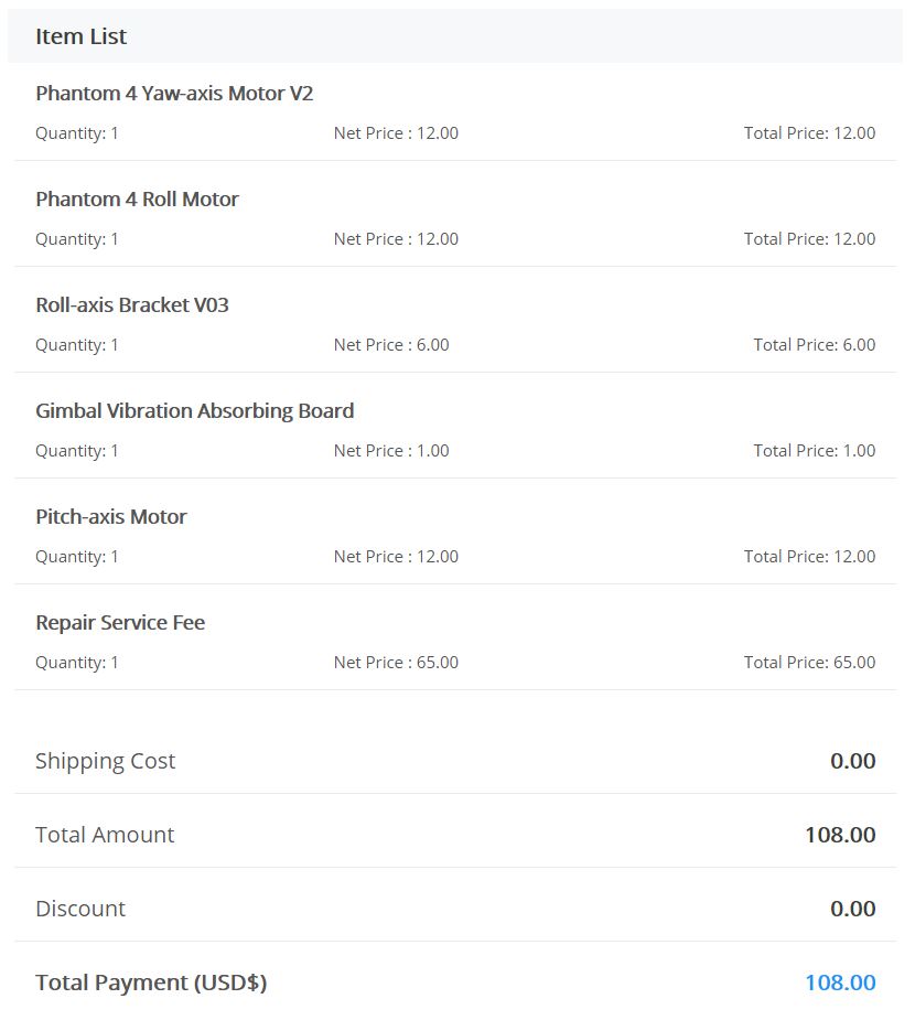

Thanks man. Actually, had already sent in to DJI. Hopefully I lucked out as the quote is below at $108. If they send me a refurb I'll know since part 107 regi/insurance/business stickers are all over the frame. Also, I believe that they have to tell you if they plan to send a replacement rather than do a repair. It's sad though, cause I could have done this repair myself. Pretty simple stuff, I just did not know what was wrong.
111774
Looks like it. I am shocked at how reasonable the charge was. I expected to get beat up by these guys. Pretty cool to know it's this easy/cost effective. Love the EDDIE profile pic. Reminds me of the day when people used to paint him onto the back of denim jackets (NYC, '80s).
