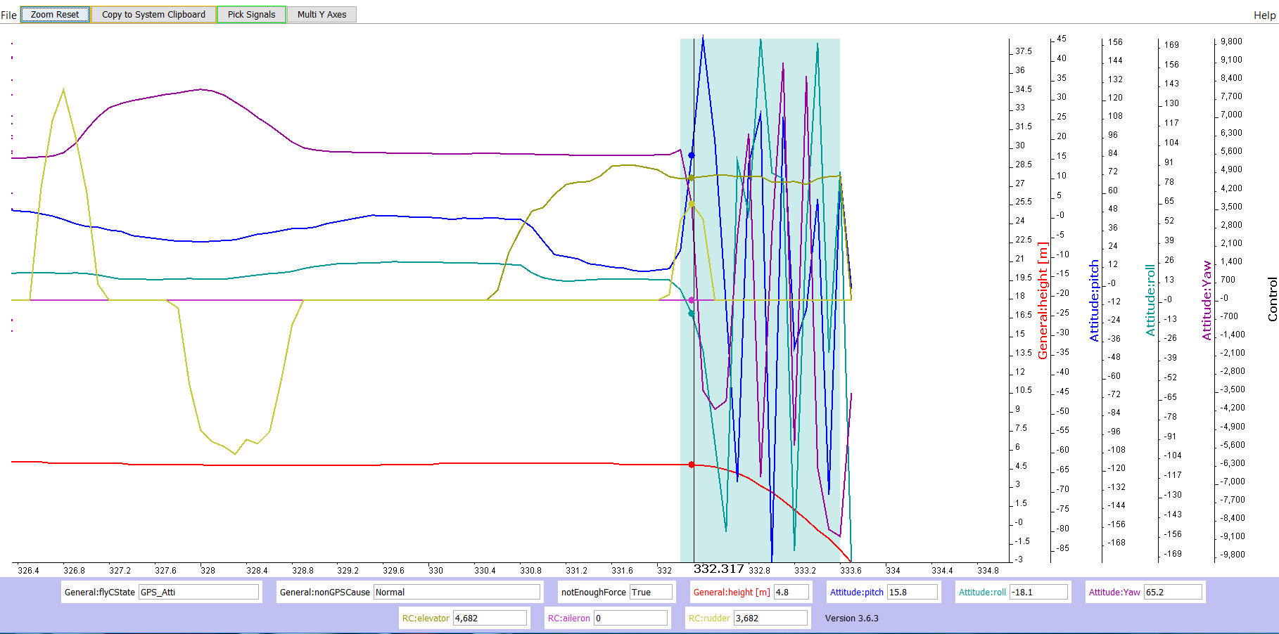

Why do you think something hit the aircraft? The pitch/roll/yaw response is consistent with failure of the left rear ESC, transferring the CCW angular momentum of the left rear prop to the aircraft.

I don't think it was a collision with a bird. The immediate response of the aircraft was the typical ~ 3 Hz spin and tumble. Even if a brief collision occurred (of which there seems to be no indication in the log), the motor would not have remained obstructed. The sudden pitch, roll and yaw excursions look exactly like every other single motor propulsion loss event that I've seen - they do not, themselves, indicate a collision.

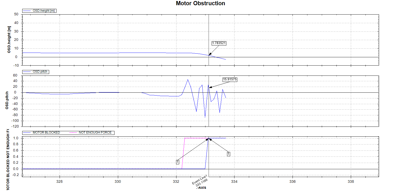

Completely agreed that the sudden excursions could very well be an ESC failure. Also looking back at the 2 flags, the "motor obstruction" occurred after the " Not enough force" flag going true. The altitude at that point per the data was ~1.7 meters. Taking that with a "grain of salt" so to speak, the "motor obstruction" message could have possibly been ( and I am grasping here ) impact with the water. The time between the two was roughly 700ms. It's really hard to say definitively.
If we ignore the motor obstruction message it looks much like a lost prop. But the motor obstruction notification precedes impact with the water, since the aircraft continues to descend and spin for another second, so I think that we have to assume it's real, and indicative of an ESC issue.
