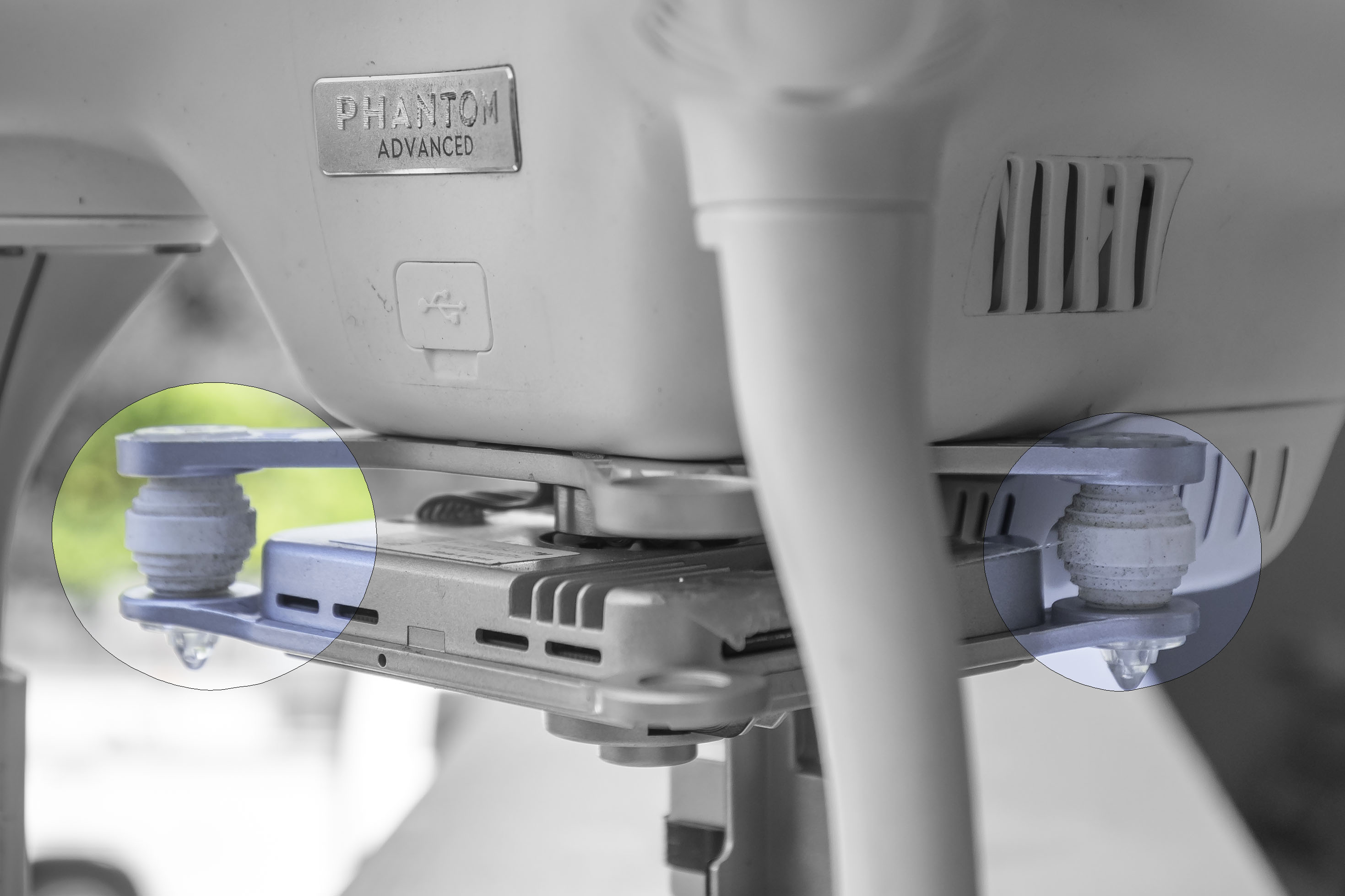

Just to be sure we are taling about the same thing, do you mean these little white rubber things that are highlighted in this photo?
I ask because you said there were four of them, and my P3A only has two of them (and two of the anti drop pins).
Thanks in advance for confirming.

You should use 4 of the white bumpers you're missing two on the picture. And you only need two of them plastic ones.

4 white bumbers, 1 on each corner.
Their function is to damp vibrations.
2 pegs (locking/cotter pins), on diagonal corners.
Their function is to prevent the camera falling off, in case of a mild crash for example.

Yes you should add two white bumpers were there is no bumpers and no plastic pegs.
