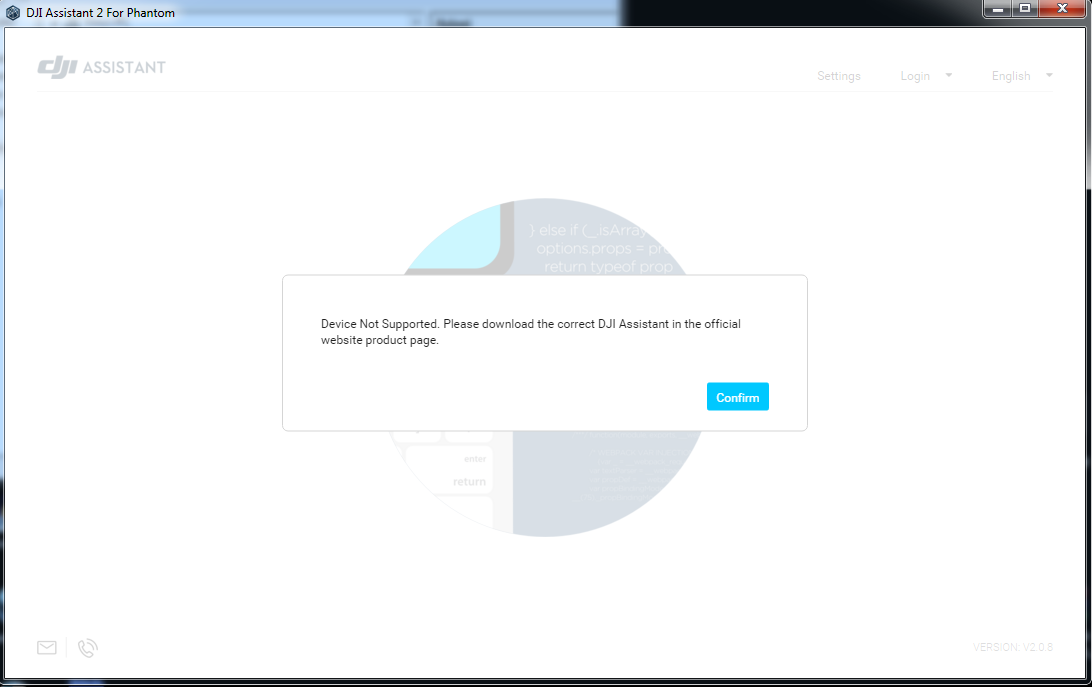

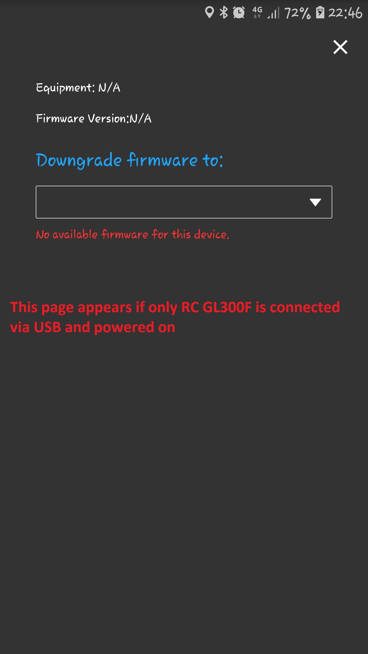

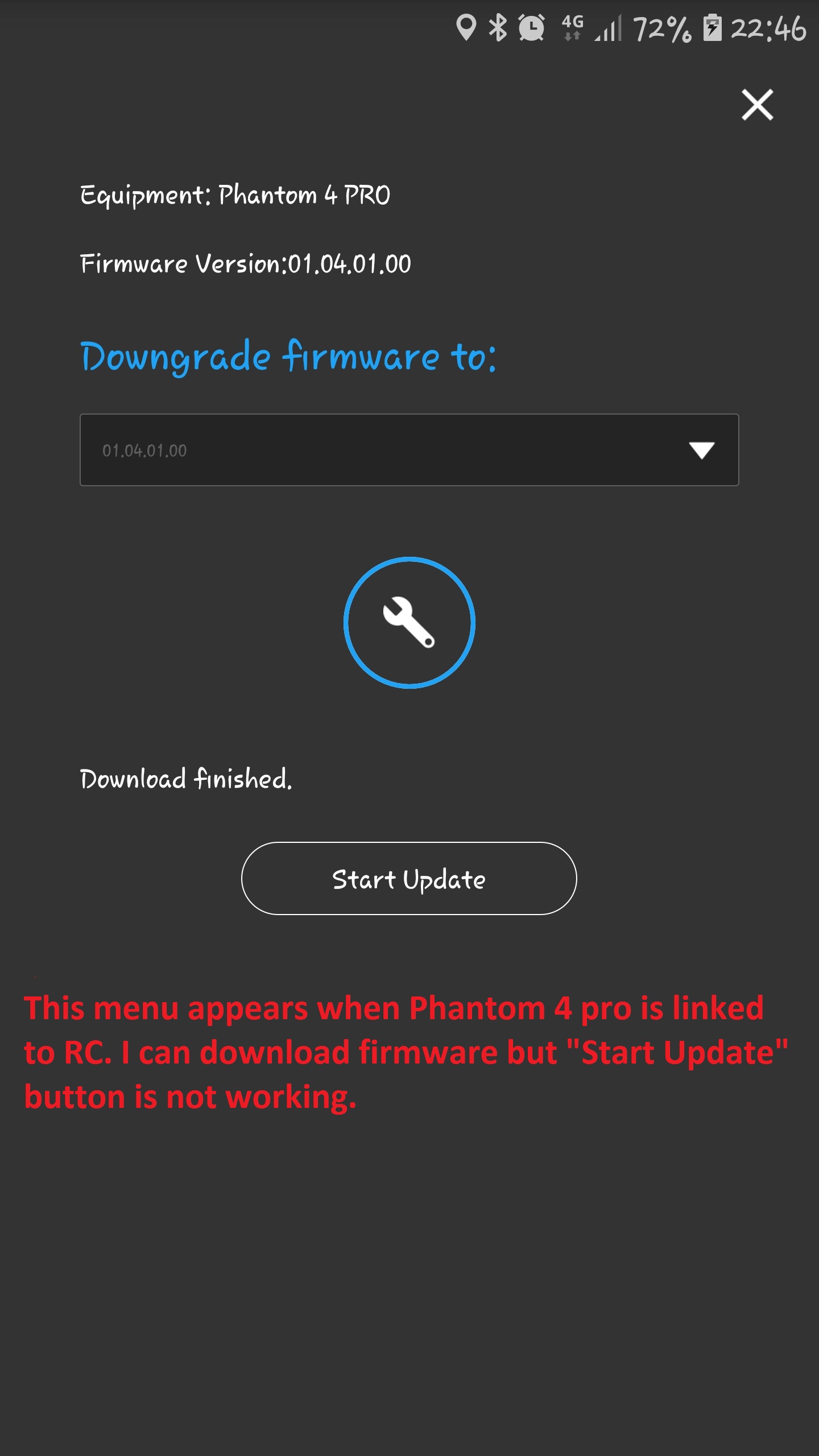

I cannot upgrade it from the DJI GO App or from the DJI Assistant.

I have tried but it is not working (see pictures on post #1)
I tryed also using DJI Assistant but it is not posible agin... (see picture on post #1)
