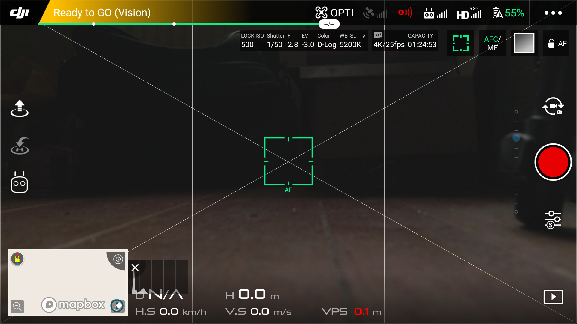

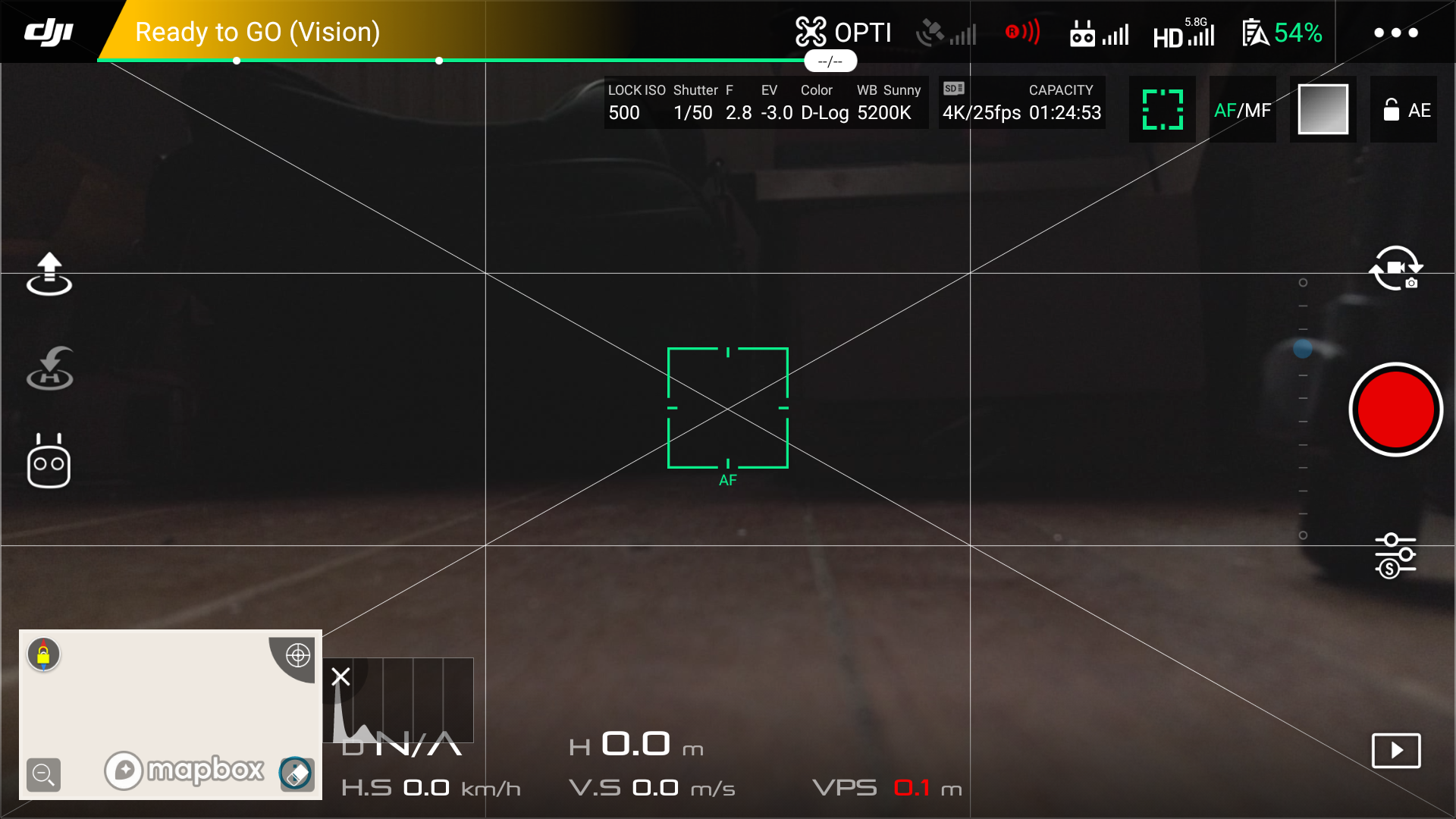

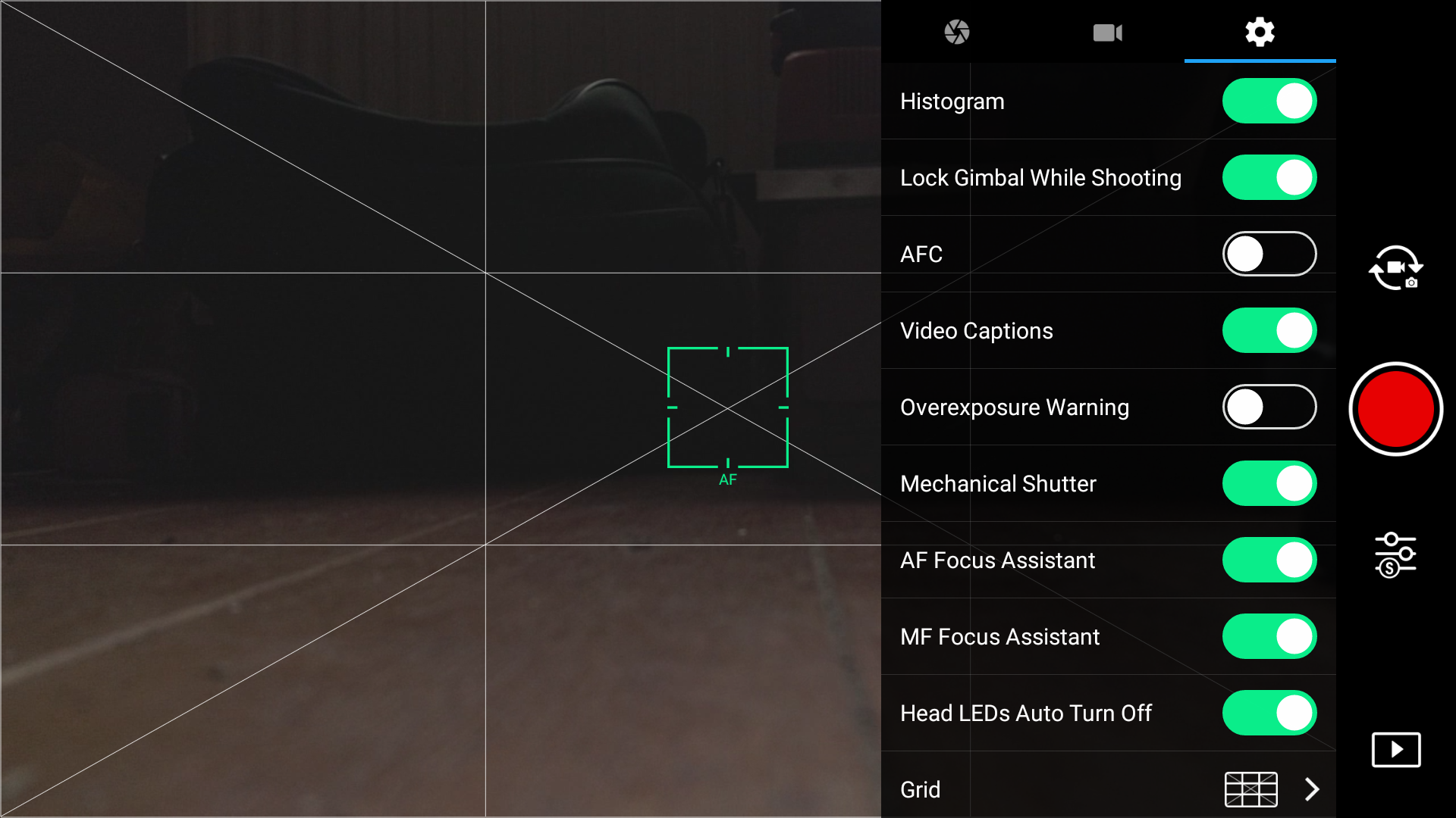

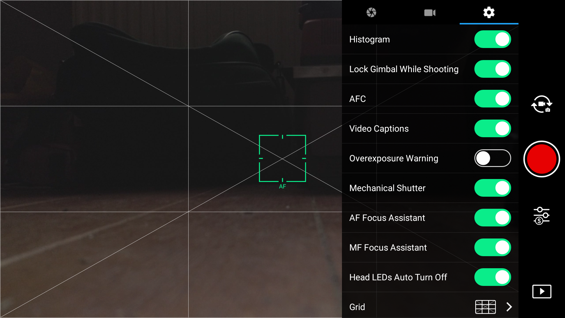

As of Firmware version 01.03.0418 (2017.03.07)
-Added AFC (AutoFocusContinuous) function to support continuous auto focus when switching between scenes.
AF does a (re)focus when:
1. The drone is powerd On.
2. The screen is tapped.
AFC does a (re)focus when:
3. The drone does NOT move for a few seconds (scene switching).
