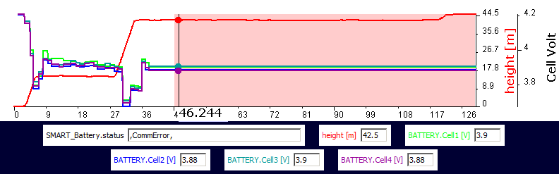

There's some data in the .txt that might be relevant.At about 38 secs the battery cell voltages flatline. Then at 45 secs there is battery communication error is reported until the end of the flight.
Looks to me like a warranty issue. Good luck.
EDIT: At first this looked very much like the usual abrupt power loss incident. But, this made me take a look at the .txt
