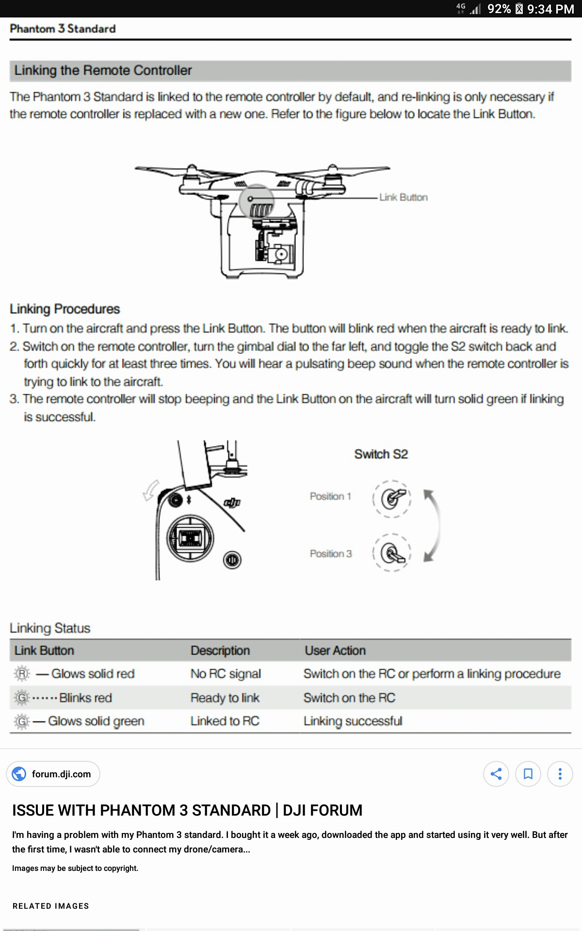

OK so in djigo app there rc setting Called rc linking,what happen when click on ? Does drone beep and time out or you press button and it still not link,,,here is a manual linking process which can do with iron without the app conected,,good luck I be reading

OK so in djigo app there rc setting Called rc linking,what happen when click on ? Does drone beep and time out or you press button and it still not link,,,here is a manual linking process which can do with iron without the app conected,,good luck I be readingView attachment 110095
Thanks, I have tried to re-couple the RC with the ship following the manual procedure but it does not respond. I have removed the battery and put it back on and sometimes turn on the green light on the ship, but it does not allow me to fly.
