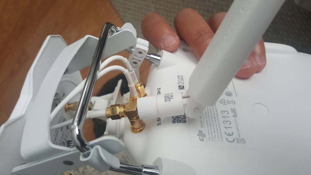

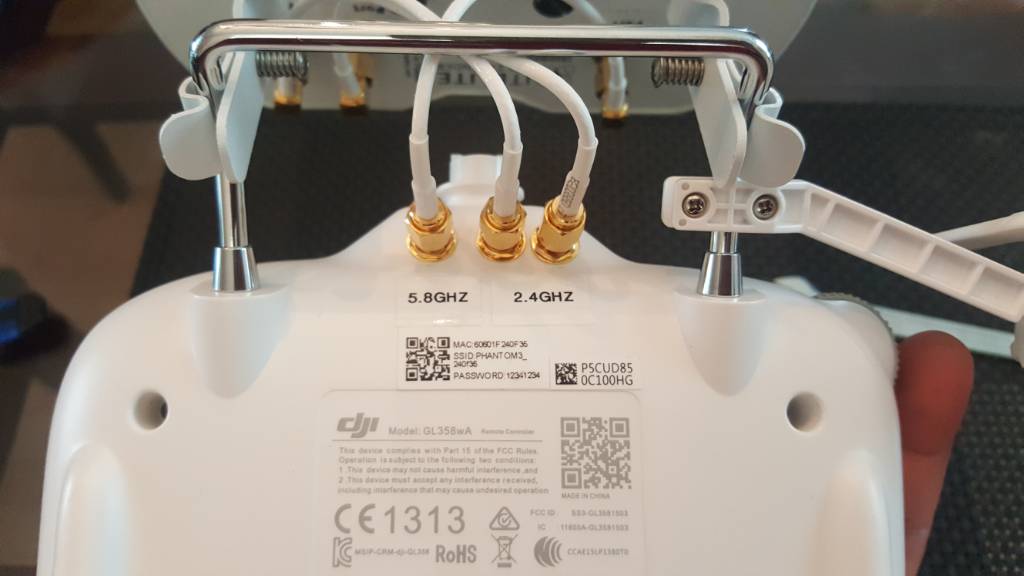

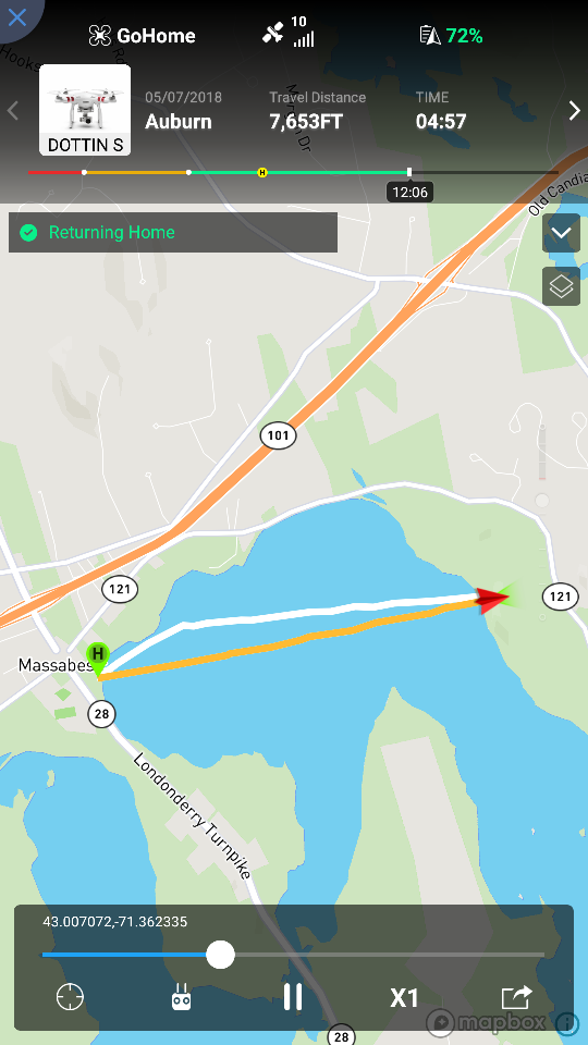

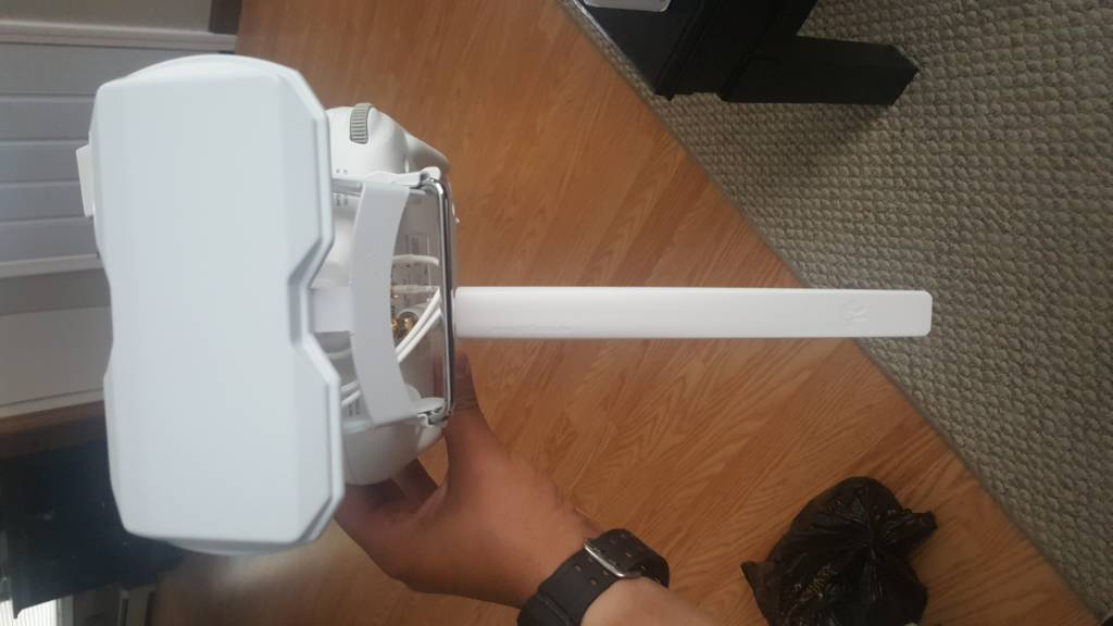

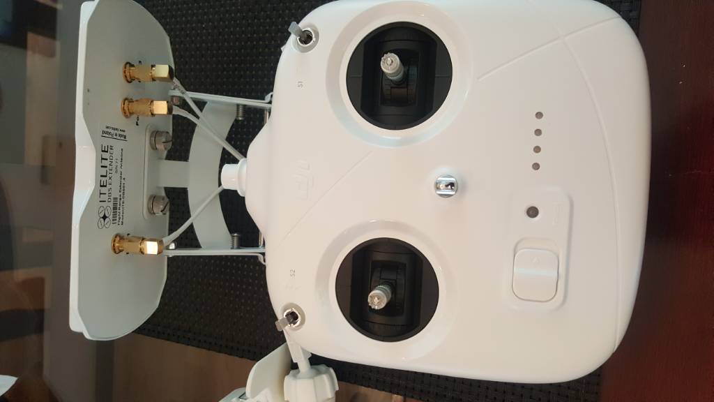

Today i test my phantom 3 standard with dbs itelite + Blue proton 10dbi omni 5.8ghz antenna with splitter and it fly over 7000ft easy...
I put the splitter on the 5.8ghz sma connector and attached the dbs antenna and the Blue proton Omni antenna

Yes return home it's mandatory on this kind of flight....the only thing that I was worried it was about the remaining battery %....but I also notice that I return home but slow speed...why?...somebody have this experience before??

It defaults to that and it can lead to losing your AC. If the head wind is against you, the AC will never make it back. In your case, it would have landed in the water. What many pilots do is cancel RTH and re-take control once the signal is restored.
