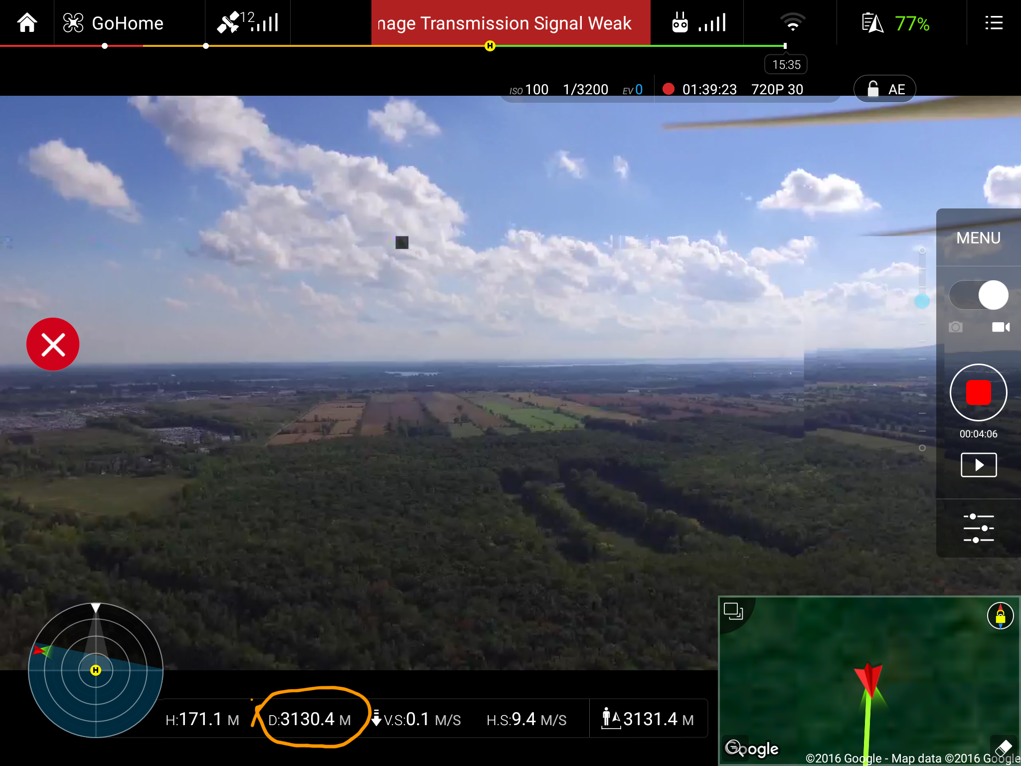

Pretty sure something is wrong , either bad connection or bad antenna , I was able to get over 10,000 feet with the Argtek. 20160920_153958 (1).png
Pretty sure something is wrong , either bad connection or bad antenna , I was able to get over 10,000 feet with the Argtek. View attachment 68207
I dont think is bad connection . i checked and rechecked the connection 100 times they are good. the installation was done by a professional .
how can i check if the antenna is faulty ?
cheers
