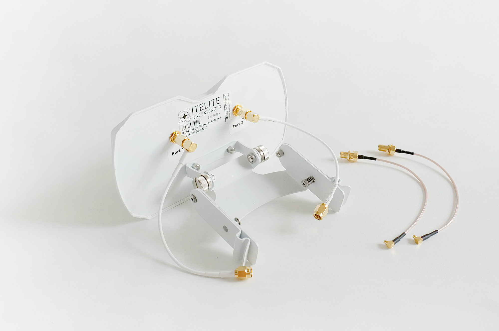

Hello I was wondering if anyone has tried this range extender antenna from ITElite Antennas? It looks like a super antenna but I'm wondering if the connection is improved.

BWSAGO: I noticed that ITElite offers professional installation for the antennas they offer. Just in case you don't want to perform the installation yourself.
Uav And Drone Antennas | United States | ITELITE ANTENNAS Inc.
I have it but I’m not really getting the distance I’m looking for with the p3 4K
You never will get much over a mile at best with DJI Wi-Fi drones. Most the time about 1/2 mile is the limit. You need a P3P, you'd be happy with that. You can get over 2 miles easy, close to 3 miles, but limited by battery life. I have one for sale if interested, $650 with 4 batteries.
