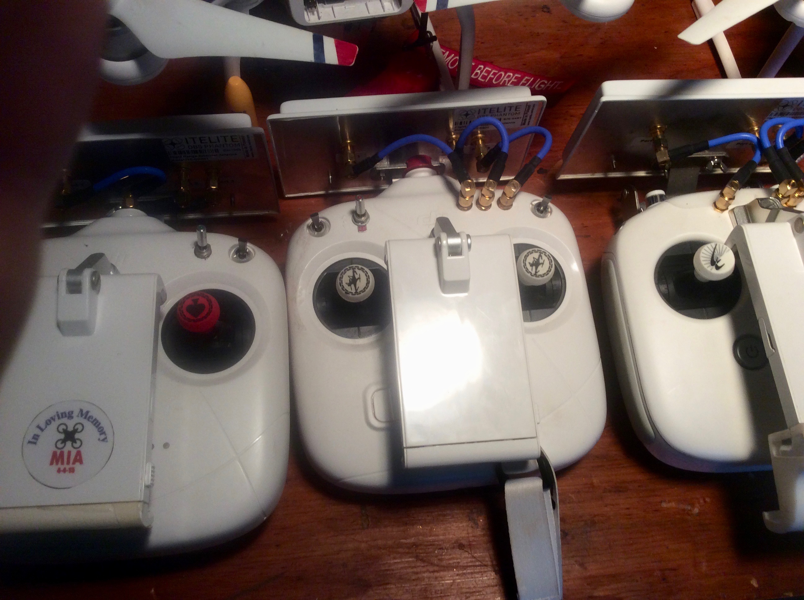

You really have to aim that panel and not be moving around.
I used to sit with the controller in my lap when I was doing
distance runs.
Make sure you have your cables not crossed and
is possible one might have came lose in the controller.
Not sure your set up but the wire in the center of the connecter could have bent over and not went in the hole.
Had that happen once.

hee thanks for the reply. i installed it yesterday and i think i installed it correctly main antenne to port 1 and does the left one go to port to and the right one to port 3. thats how i have set it up. I tried it in open field today and i would get about 1.2 km before i lose connection its about the same as the stock antenna. ive used both litchi and dji. did you use auto channel select on transmition settings
Yes but now looking i didn't have the SE and would have to look back in lots of post to see just what went where as i don't have the Phantoms anymore. The left port on the panel is 5.8 and the other 2 on the right is 2.4.
I dont have the se either but have you tryed a port 1 into port 2 just incase and port 2 into port 1,just a idea
