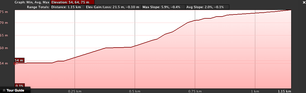

I guess Florida is quite flat but I think it is a good idea to nevertheless inspect the mission area in Litchi Mission Hub on a PC because it shows the ground elevations at each waypoint.
Doing the same in Google Earth is even better because you can just move the cursor on the whole planned mission path and see the ground elevation at the bottom right. Or create a path, set it Relative to ground, and see its elevation profile.
I heard that some new version of Litchi might make setting a constant AC altitude from the ground easier. I.e. you don't have to manually calculate "AC altitude + ground elevation" in each waypoint (currently a detour to Google Earth is needed if you want the calculation is done for you). Is this feature currently in beta?
Thanks for the demo Matti! This is what I needed to figure out how to plan a mission flight through Google Earth!
