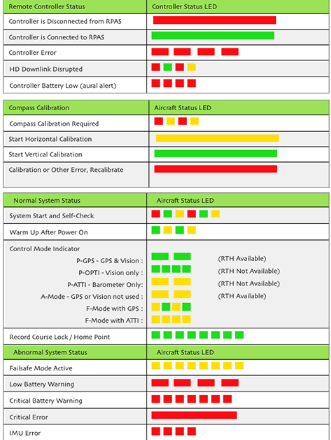

Google DJI Blink Codes and go to images

I don't know why you're having problems but try start up guide, good luck!

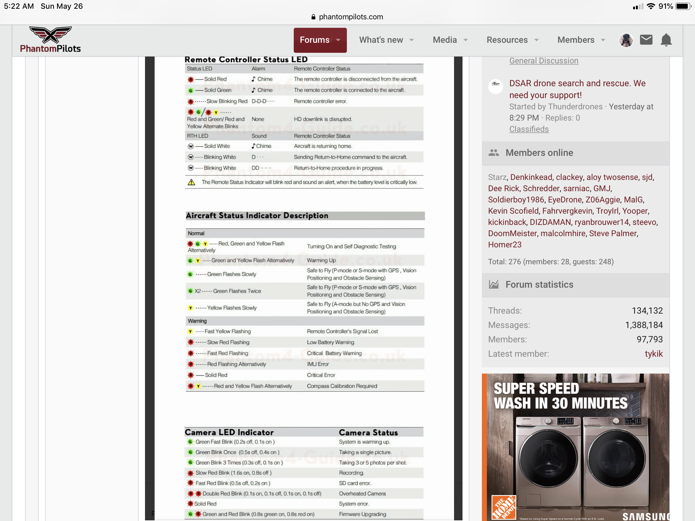

The colors/sequence of the lights depends on the mode the MC is currently set no? My drone was doing the red,green,yellow but after a calibration it is now solid red, the compass is damaged and waiting for the new one to arrive. The motors turn and the P2 v2.0 is on NAZA-M mode.
