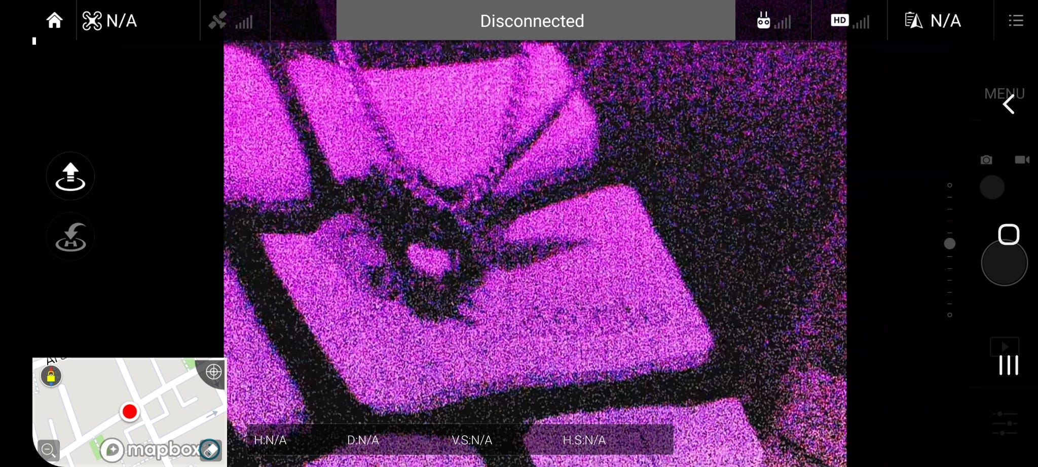

hey guys, i have phantom 3 pro and when i connect it to the app i get alot of purple dots where the shadows are, i tried to change the flat cable and it still happening,
there is some test, things i can do?

Not sure what I'm looking at there? What's the camera pointing at??
Does the drone fly? Try taking a few stills and a bit of video, what do they look like.
It looks like a lot of colour noise, possibly from use of high ISO setting and amplified by high zoom. If you could provide camera settings and a full non-cropped image it may help. This looks like an image of a bracelet. I also see what appears to be writing near the bottom. Could this be a still shot of an item in a catalog. Let's be clear about what it is. Perhaps take a still shot of a landscape while the drone is in the air, too. Post all images without any post editing done to them.

Bad cable connection in the camera head will do that.
