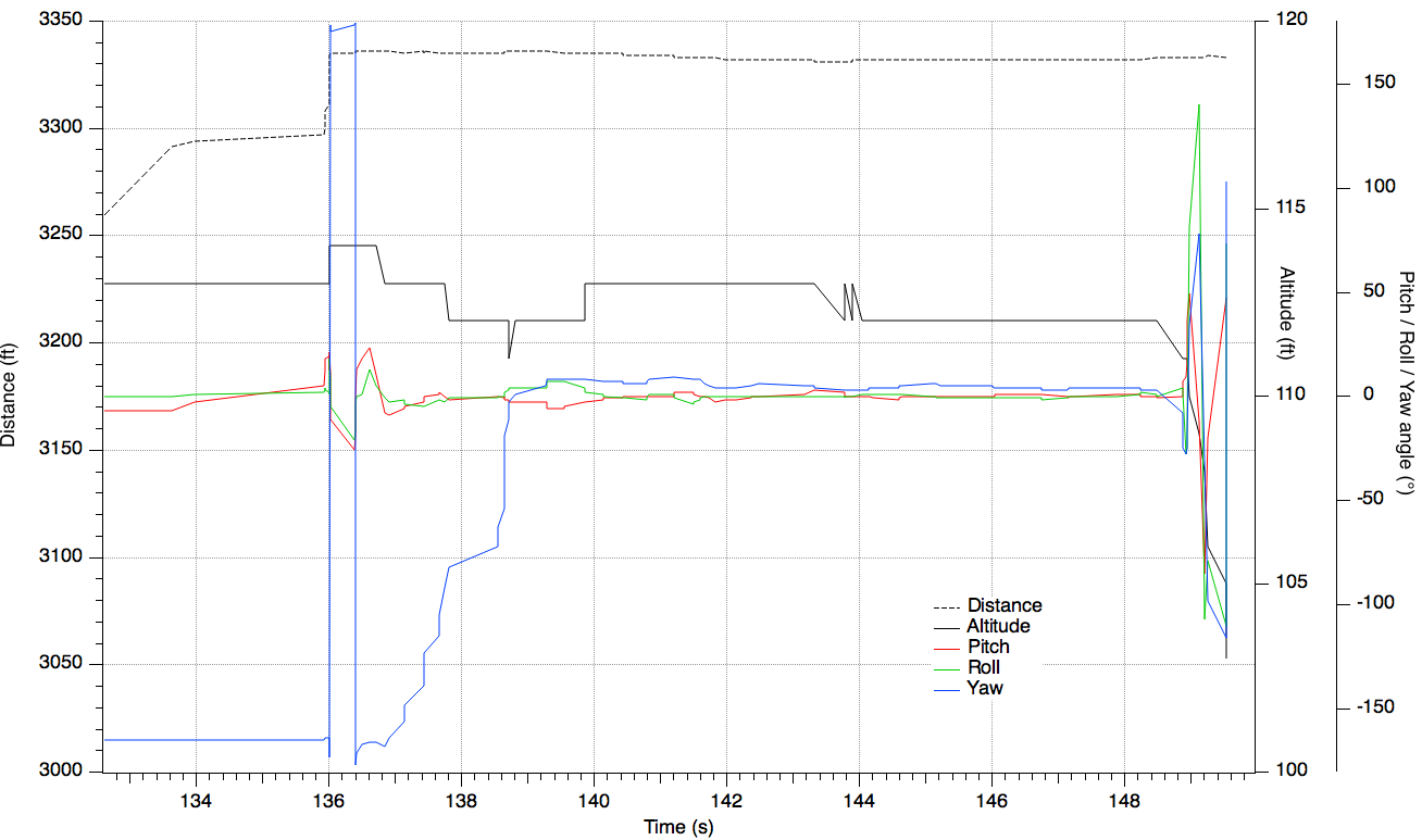

Perhaps I've lost track here - what is left to explain?
Sure. The OP stated the AC was never supposed to go as far as that building. He thought maybe Litchi went awry and was ultimately responsible for the crash. I asked it he had saved the Litchi mission and if so, he could post a link and we could double-check his settings and waypoints. He replied back that he did not save the mission, hence my reply.
OK - I missed that. I somehow doubt that Litchi was the problem though.
Yeah, I also missed that. :)

And it does explain the slightly odd features in the log file shown in post #13. The event at 136 seconds was not the result of Litchi turning the aircraft back towards home - it was the first impact, which did not crash the aircraft. It pitches up and spins clockwise to face home (towards the parking lot), and then hovers, descending slowly for 10 seconds. Then it hits the sloping roof again, which causes it to crash. The video of the final moments of that crash were not written to file.
Slow-motion crash video: Dropbox - crash.mp4
It looks like it recovered hoovered for a bit then crashed
