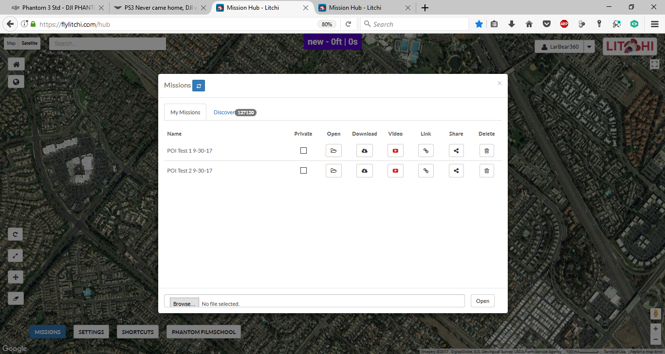

I got it to play and will post a link to it. It was totally too low. It flew right into the roof, then flips over to an image that makes it look like it was flying back. The way it hits the roof there is no way it could have turned around. Question I have now is did it fly further than I told Litchi to fly? My intent was to not even get close to the school, to turn around at the end of the open space. But.. mistakes were made by me.

Cody, we would need to see the original mission. Go over the flylitchi.com/hub where you can load the mission. Then click on the link option.
