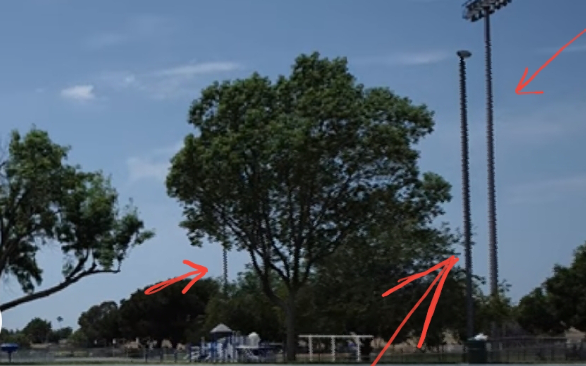

The vibration's there, alright. Ianzone - focus on the poles. Or time for a larger monitor, perhaps? :)
I have no idea what it could be, especially without the motors running. I suspect a gimbal problem... anyone else?
Lol and some glasses might be needed to I think

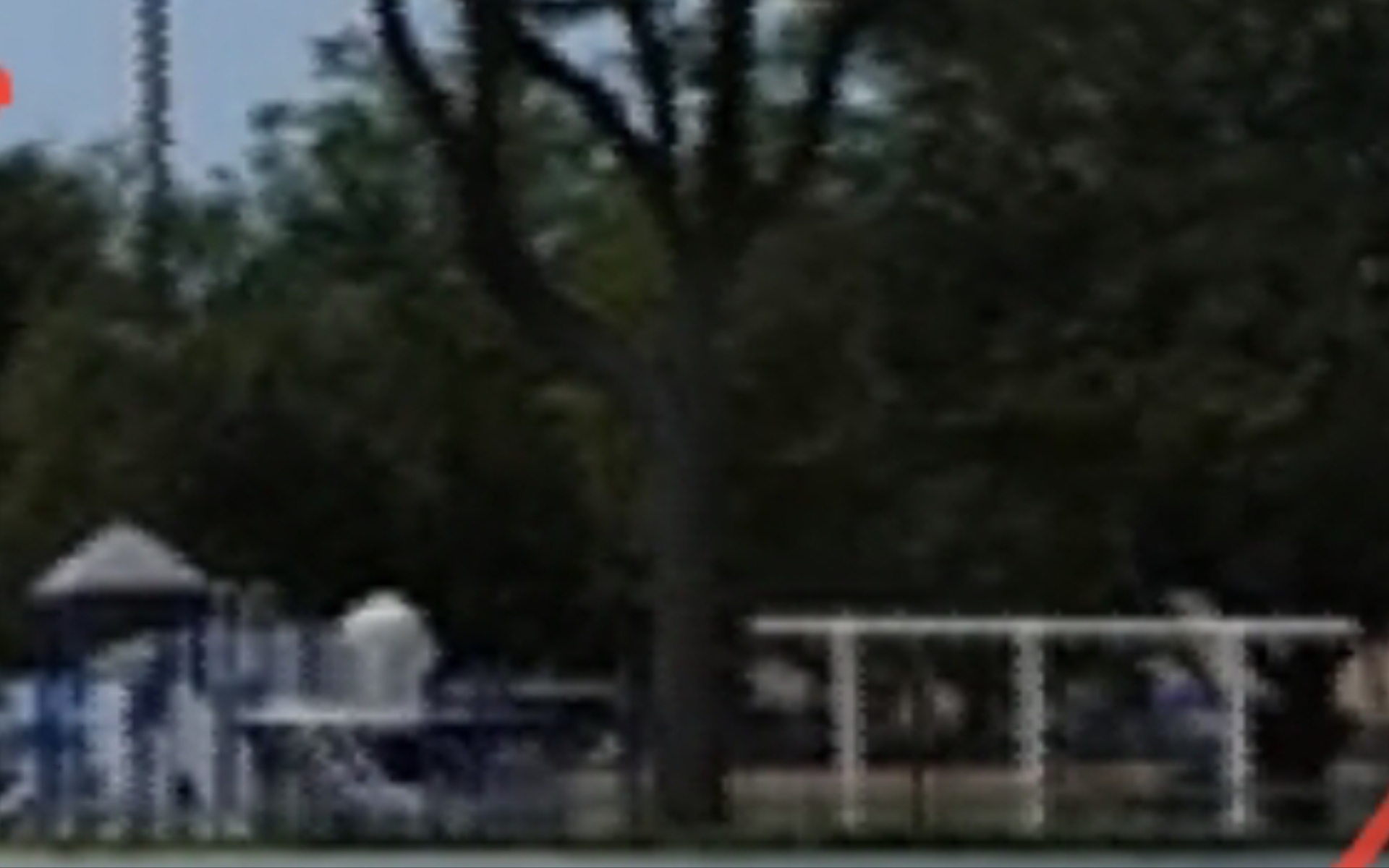

Is this what we look at,I watch on my 10/1 tablet but not see this noise like pattern till I zoomed in,,,other posts are normal,,I expected to see the actual clip moving around bit more,,posts,white table,tree branches, after zoom I can see all of it

Are you referring to the squiggles on the post where I put arrow,,have a look in your settings and turn on and off the noise reduction slider switch ,,or over exposure switch and maybe try different cam exposure setting ,I dont think the cam is vibrating just looking at clip,,its something in the cam setting causing it I'm thinking,

Definitely no vibrations. Sometimes the effect like vibrations can be because of low frames per sec.
And the resolution also can be the source.
Whatever I don't see vibrations in your clip.
What was the frame rate on the softball video? Did you use ND filters to slow the shutter speed to double the frame rate?
Cool I dont need glasses then lol,,,agree,no vibration but clearly a noise issue! Faulty sensor mayby if no cam settings change anything,I read that sensor thing somewhere before
