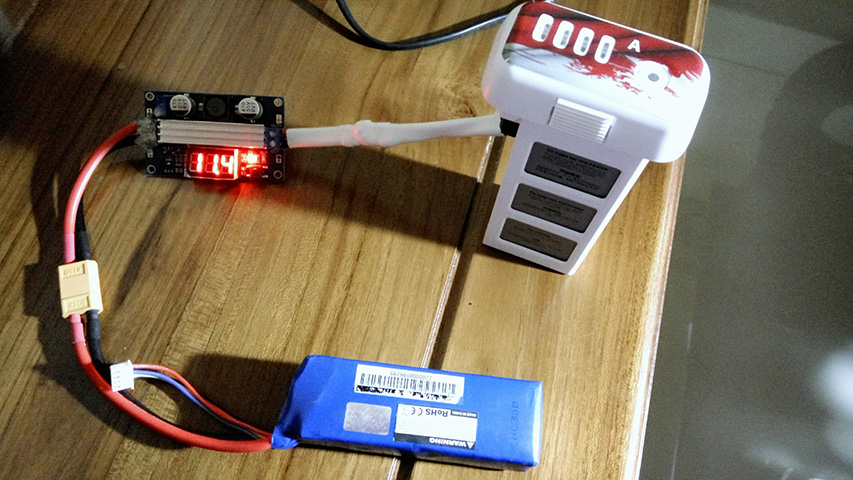

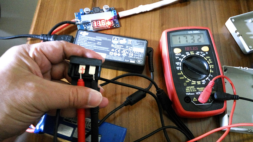

I have a couple of lipo battery, after buying a few parts at store and do checks:
This is the result, for emergencies only :lol
**Edit: Resize image & video
Reactions: petermeter
