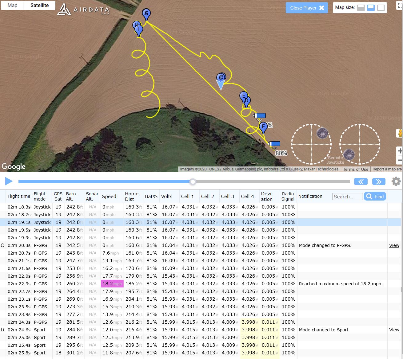

My P4P shot off once in DJI go 4 and crashed into a soft hedge. Also twice in litchi following a pano shot on returning to home. Spiralled uncontrollably at 100m. Flight logs gave false joystick input. See attached pic.
Forums report similar errors using litchI. Switching to sport mode and back is supposed to help but didn’t. Had to switch off controller in the end And trigger an automatic return to home.
My controller had started to beep on startup requiring a joystick callibration and also gave an overheat warning so I am assuming it is the controller and needs servicing.
Marc. Good info and quick thinking on going to sport (sport and back) and / or off. Just guessing this has never happened to 99% of us (my hope anyway).
