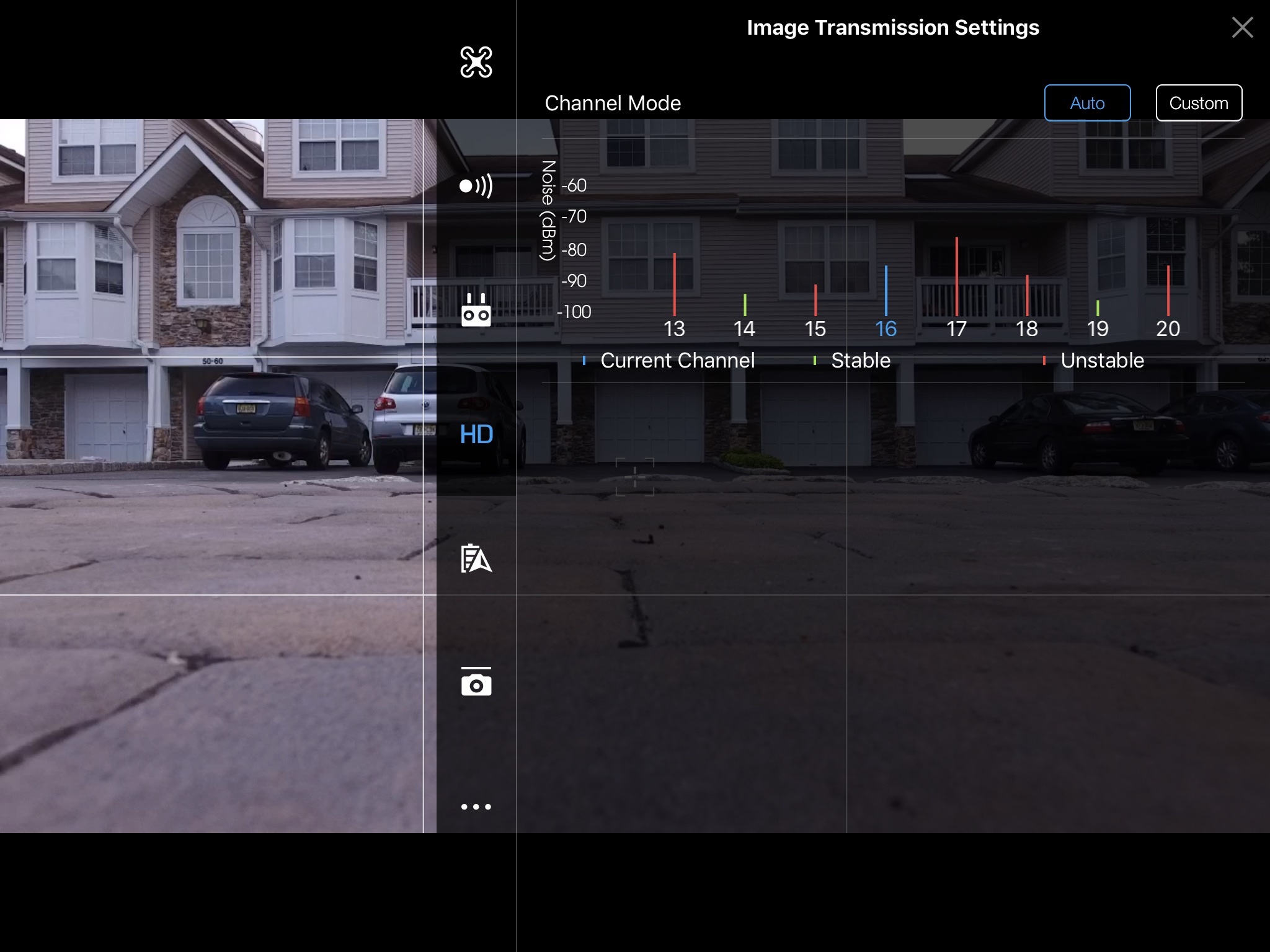

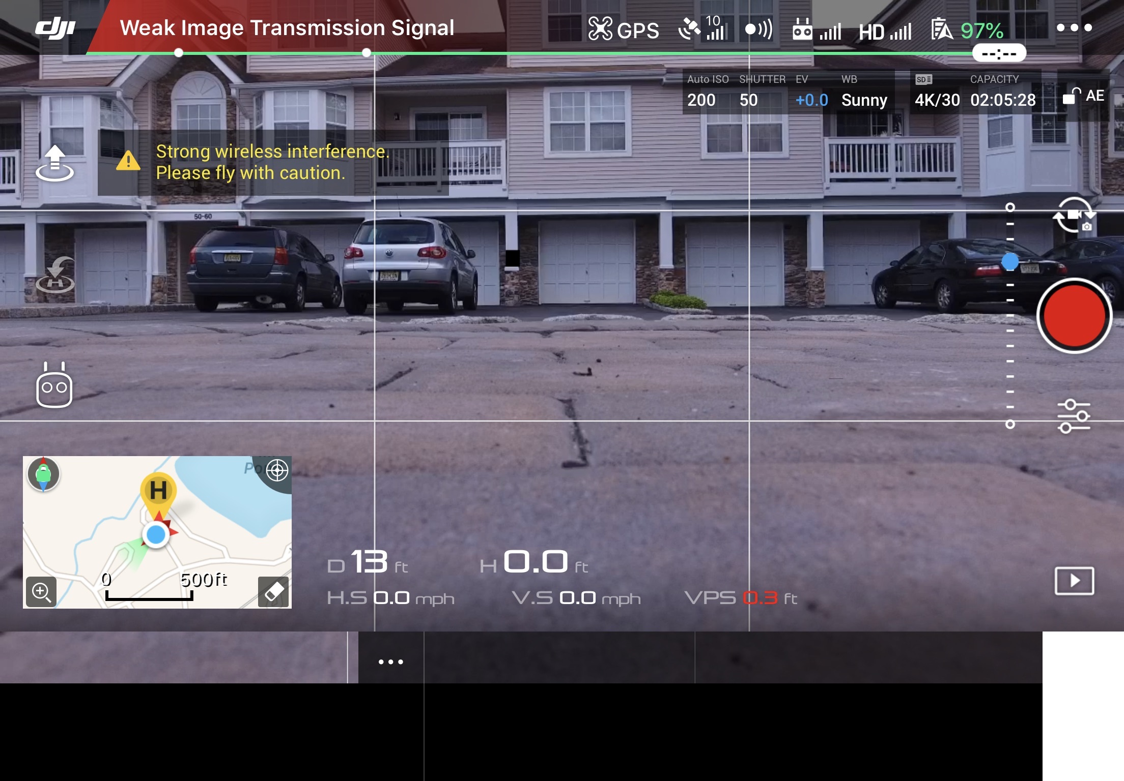

I had my P4 sent out to DJI due to an issue with a firmware upgrade back in December of last year, and had ignored the fact that I was experiencing this issue, because honestly I hadn't flown it much since... (I've been playing with my Spark more). Today, I decided to fly my P4 and had the warning about poor radio channel quality. I waited for my home point to be updated notice (had enough satellites), and started flying. I got a good about 2000 feet out and it 380 feet high and it disconnected. Prior to me sending it out for that firmware upgrade (the one that nobody wanted), I had never had a disconnect from my drone or this poor radio channel quality issue. I've flown that distance before at this same location without any problems. I just emailed DJI to see what they say. I use an iPad Pro (9.7 inch version). I tried the suggestions listed above after this incident, but I'm still getting the poor radio channel warning. (Cleared cache, closed everything out, set it to 4mb, etc).

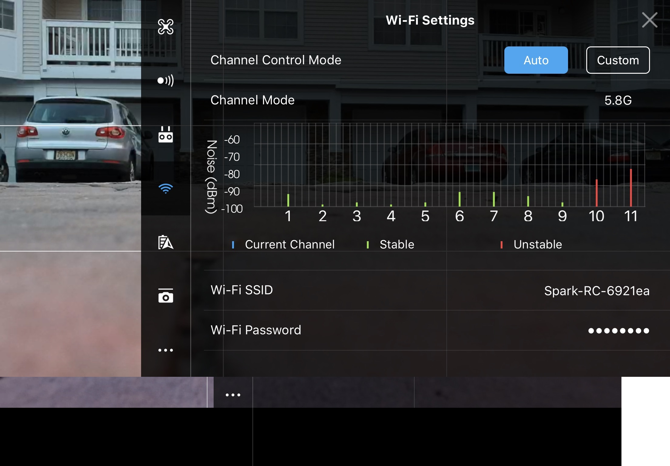

DJI wants me to send them a "video of it happening." Been busy to do so... I sent them screen shots of what's showing up on my DJI GO 4 App, and am waiting for a reply. Getting really annoyed. Wish I had an answer for this... Flew my P4 yesterday and it had the same issue again, then flew my Spark in the same spot... No issues with the Spark.
Attached are what my Phantom 4 showed, and then the 3rd one is my Spark... The Spark showed no issues.
