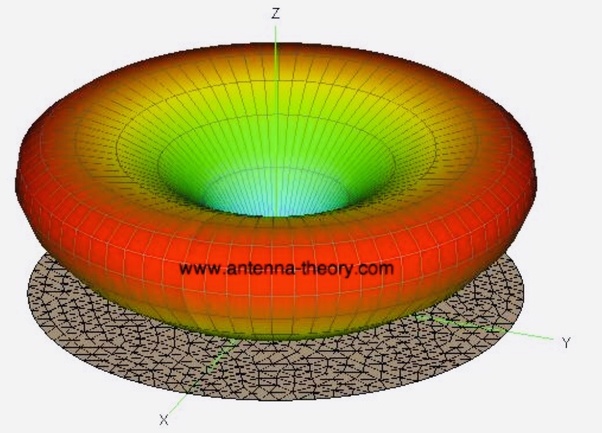

Don’t point the ends of the antennas at the drone. There are “dead zones” off the ends of the antennas. Best signal strength is perpendicular to the antennas.
On the attached figure, the Z Axis is the antenna. So the antennas on the transmitter and drone each have dead zones that can affect signal strength/quality.
Plants, trees, leaves, automobiles, buildings, metal objects, and your body can also block or attenuate the signal strength and quality of radio communications. Unless you are comparing signal strength/quality now vs previous experience under similar if not the exact environmental conditions, your perceptions and expectations may be wrong.
