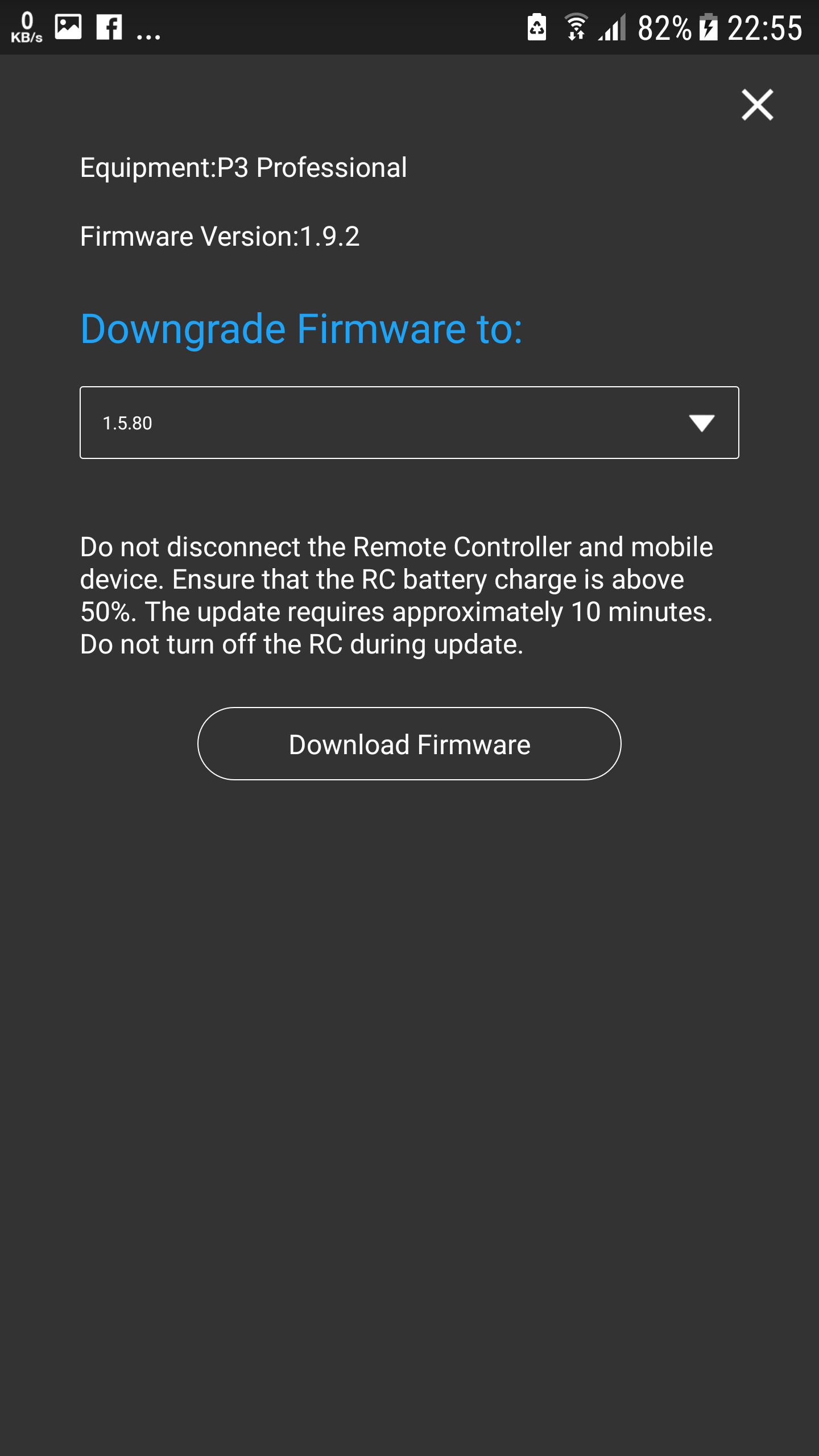

T tunglam Joined Mar 10, 2018 Messages 1 Reaction score 0 Age 30 Mar 10, 2018 #1 Yesterday I updated firmware v1.11.20 for phantom3 advanced phased phantom rc, when update was complete i could not connect to the plane, and i checked it has switched to phantom 3 professional. How to convert it into p3a? Attachments Screenshot_20180310-225546.png 119.6 KB · Views: 362
Oso Premium Pilot Joined May 19, 2015 Messages 4,993 Reaction score 4,176 Location Western US Mar 10, 2018 #2 Have you already tried to relink as per the suggestion in the 1.11.20 release notes? Reactions: JoBe
