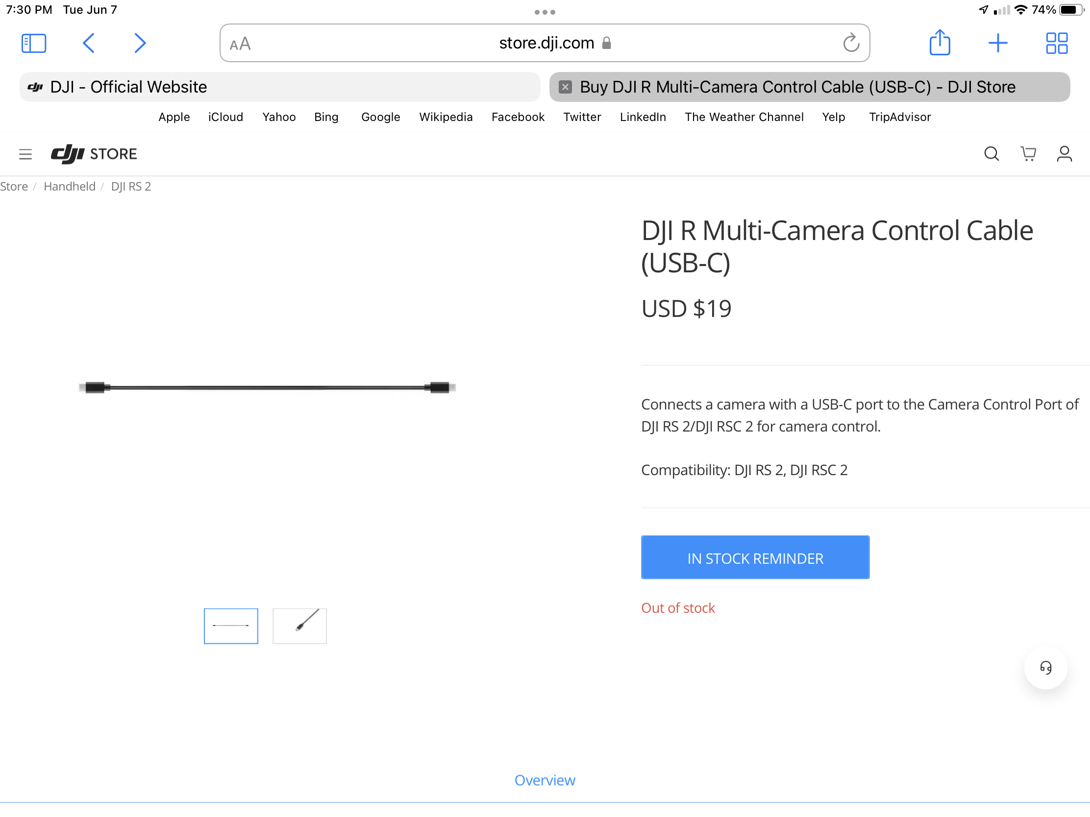

DJI cable? I don’t have any of the mini drone models, so I’m without.
I‘ll start looking for something like what you have.
The only cable I have is an Apple product and it’s a no go.
I did find on DJI website this one, but of course they are out of stock.
Any suggestions?
Any suggestions?

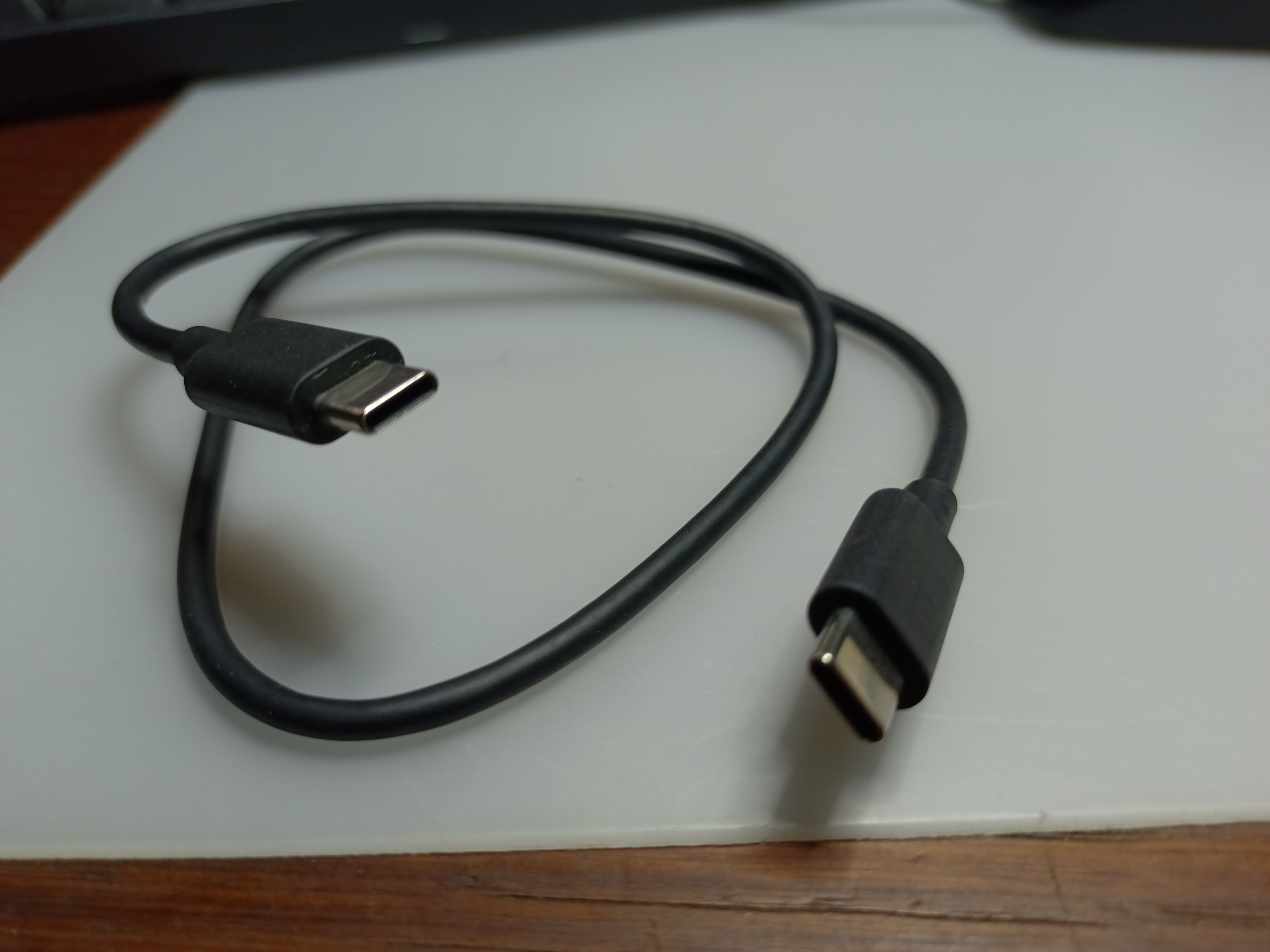

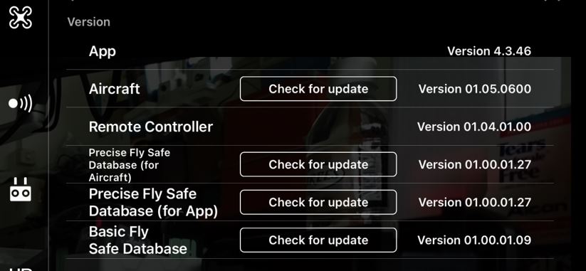

I checked connecting several USB C data cables with the Syntech connector to GL 300F to my P4P V1. All cables could connect the RC to iPad Mini 6. The USB C charging cable that came with the iPad Mini 6 would't connect at first but after several attempt and connecting/ disconnecting the Syntech connector/ cable it could connect. Also try changing the 3 connectors. FYI I am attaching the App & firmware versions on my P4PV1.
I wish you can fix the issue ASAP.

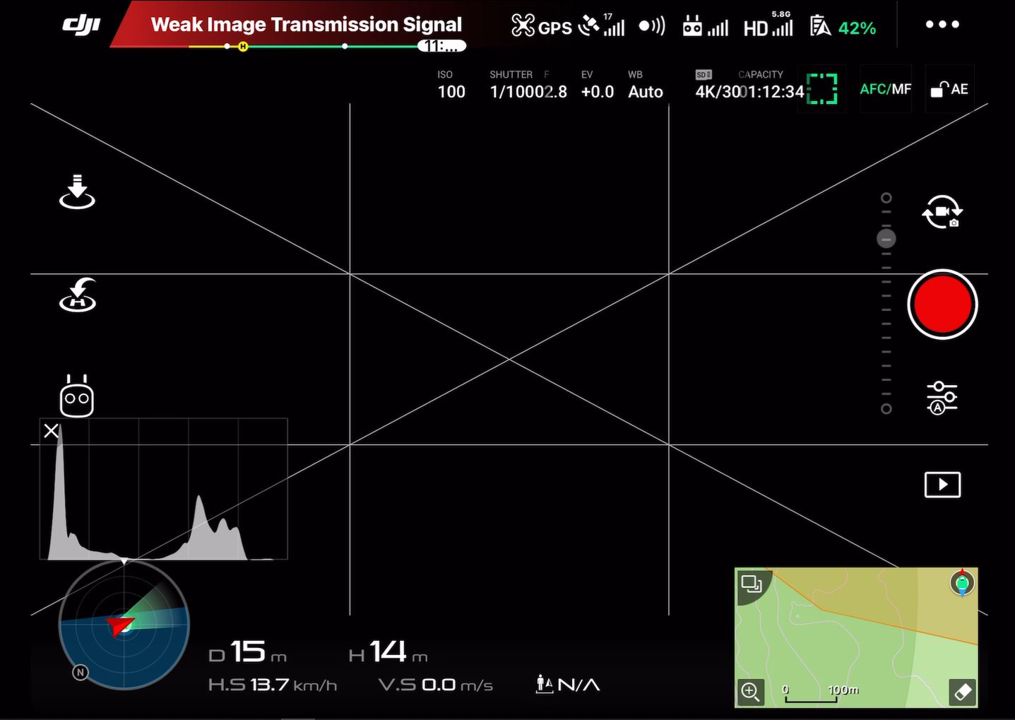

Although I was able to connect the iPad Mini 6 to the P4PV1 RC indoors, I find the connection very unreliable when I tried to fly the AC with the Syntech Connector. The iPad keeps connecting and disconnecting with weak image transmission signal warning. I am attaching a screen shot of the issue.
